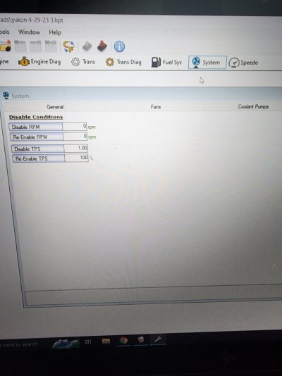

I think it’s actually done! There’s two small things I’m gonna change/play with tho. For one the compressor kicks off under 100% TPS which is good because you don’t want to destroy it. However, it only reenables at 0% TPS, problem is at idle the truck is at 11.6% TPS. Therefore the compressor won’t kick back on until the key is cycled. Kinda dumb, not sure what the problem is because the re-enable at 0%tps is a factory setting.
Also during his struggles to make my truck not stall returning to idle he pumped some of the throttle cracker airflow cells really high at exactly 16mph. So when I hit 16mph it tries to rev up to 1,800ish. I’m gonna drop that back down now that the maf is dead on.
Lastly if gonna play with my Efan settings a hair because I burned up another fan relay for seemingly no reason.

not sure if compressor is controlled by bcm or not for your years, but it should be in the little fan system icon if its controlled by the ecm
I sent you the tune from my Camaro a long time ago. Compare that to yours on the ac stuff. I've never had an issue with that, only slight idle issues when a/c is on and I'm coming to a stop. I'll sort that out when the time comes

I will look when I get a chance, I have a few other factory tunes to copy from, as well as my RCSB that ran flawless and never had AC issues.
No...it's controlled by the bcm in gmt900s (atleast for auto climate controlled*) so the ecm doesn't do anything changing those. not sure if same for 800s...
Oh yeah, gmt800 it definitely makes a difference lol.
