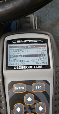

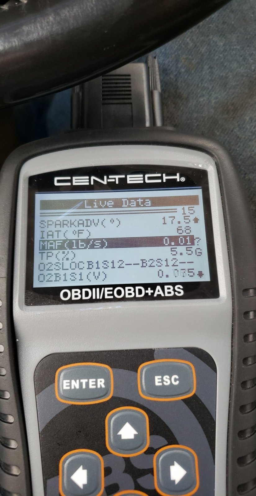

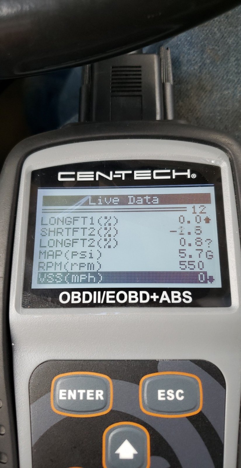

I removed the throttle body and cleaned it and unplugged batterie and no change... I have yet to clean maf sensor
