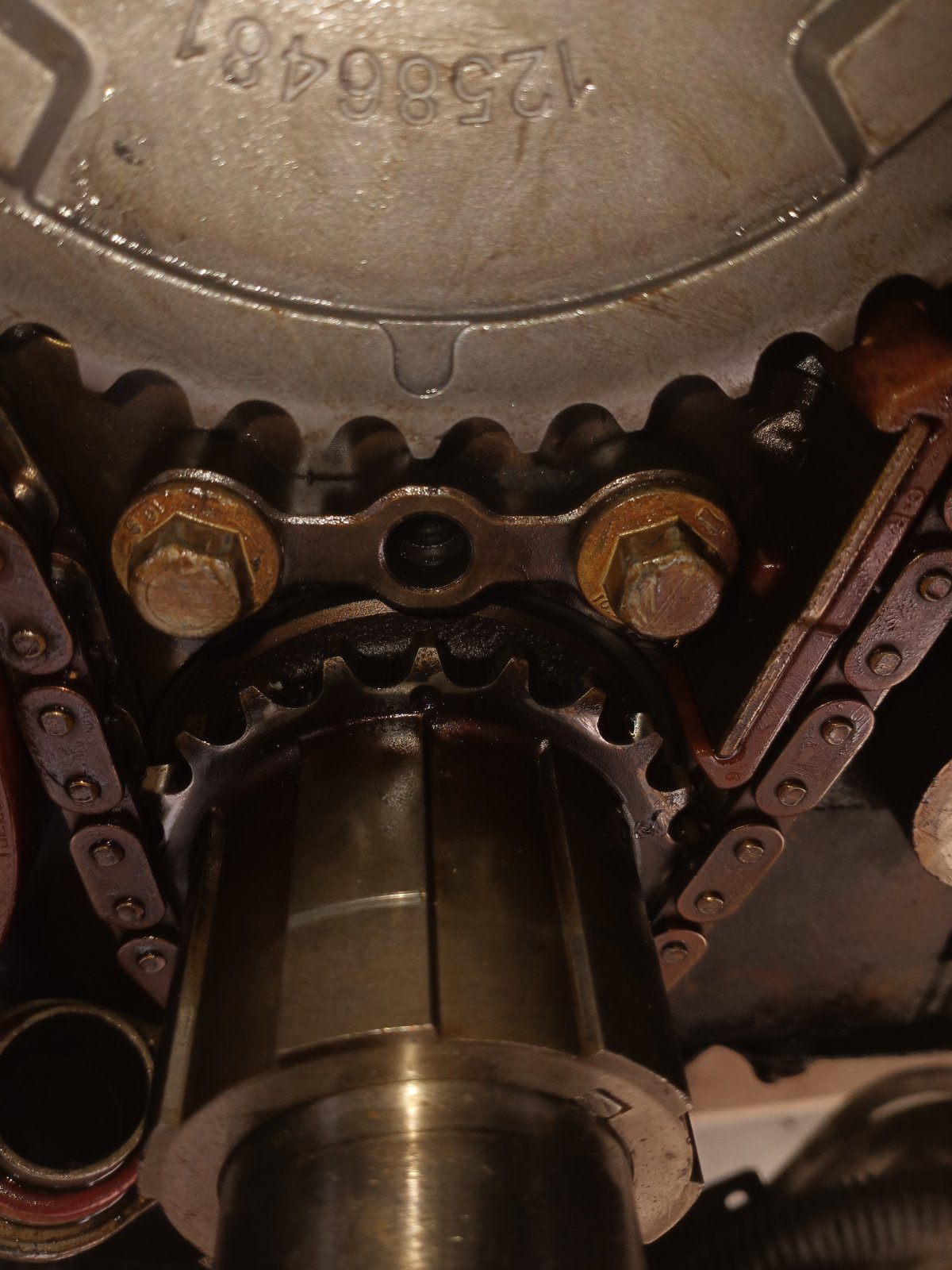

As for crank placement before or after removing cam is irrelevant as you have the heads off and therefore the valves aren't there to be opened or closed and you are replacing the cam.
The dot on the crank gear should be at the 12 o'clock position and cylinder 1 should be at TDC.
And the dot on the cam gear would be at the 6 o'clock position. And with the cam having the pin on it, its easy peasy
