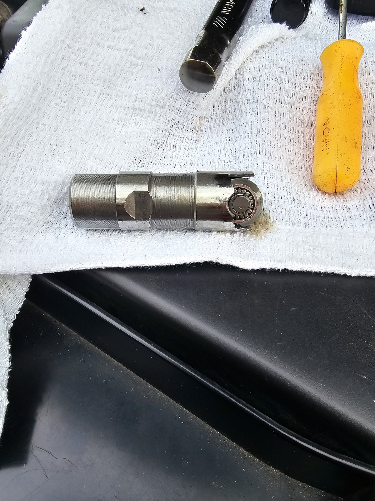

Well couldn't find anything else to go with so said the hell with it and ripped the top back apart. Found this wonderful little guy all the way in the back on the driverside. Brand new freaking parts, just grenaded itself. Can't find the chunks that are missing. Hope there in the bottom of the oil pan.

H O-Lee Chit Batman! That's horrendous and I'm sorry for your troubles. I hope things get sorted out soon.
I don't think that lifter failure can be blamed on the installer. I hope your friendship with this guy is not ruined.

No not blaming him for the lifter failure. Just in general of spending a grand on me without me even knowing what he was doing that's what pissed me off mostly

Still doesn't explain cylinder 1-3 being wet? Looks like that lifter turned 90 degrees at some point..
Have heard bad things about aftermarket lifter guides, might want to make sure you use factory parts there.
