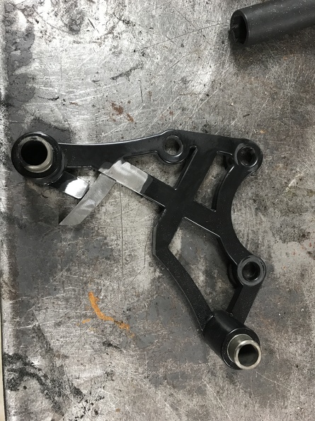

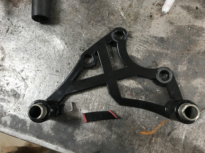

Forgot the pics of the brakes... Seems Power Stop doesn't do ANY prep to these calipers before powder coating them. A little disappointing but they really didn't cost much. I don't know if a new set from them will be any better... Any one else have them???

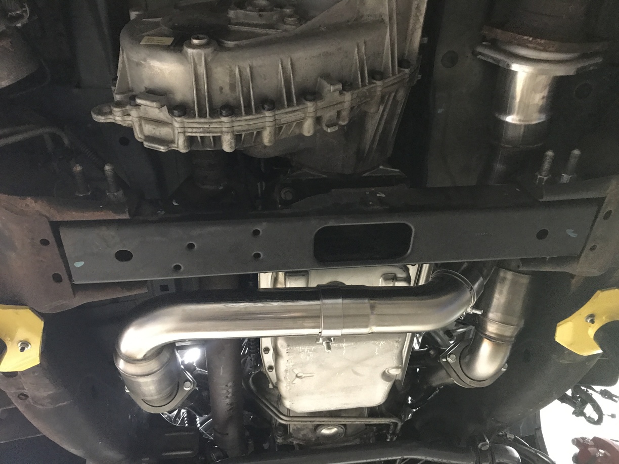

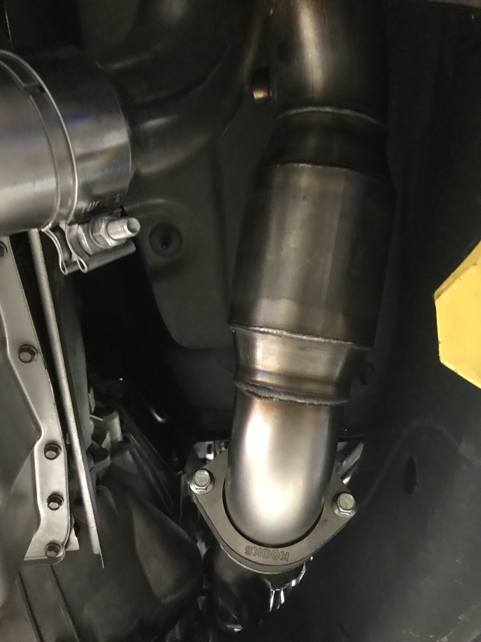

Small update today with not that many pictures... I have a migraine from hell and will post another update tomorrow with better pics. A few days ago I finished the suspension up and got the new front wheel bearings installed. Transfer case came out as well as the drive shaft so the Transmission can come out for the rebuild. Still deciding how crazy I want to get with rebuilding it since I am very ******* my trucks and AWD launches aren't easy on a trans with 600 - 650hp. Transfer case will always be the weak link but I don't wanna rebuild this transmission again. Right now I am leaning towards a PATC Level 3 rebuild kit that comes with 300M Billet Shaft and welded hubs included.
Anyways, here is a pic with the long tube Kooks installed on the Drivers side. Both are installed and will snap better pics in the AM.

The PowerStop Rotors are on as well but I didn't take pictures yet. I decided to return the calipers because the shit ass power-coat job. I will just end up painting them. Any suggestions here? Brush on vs Spray? I will try to post more tomorrow or over the weekend. It's been tough with my concussions... Feel free to ask questions and I will answer to my best ability.

I'm certainly lucky... My friend built his house and shop as well. I don't plan on buying new calipers, the rears are newer and I didn't wanna bother cracking them to have the hassle of bleeding them. They can kind of be a ***** to bleed some times. Which paint do you like to use?

I don't remember the brand, it was caliper paint though.

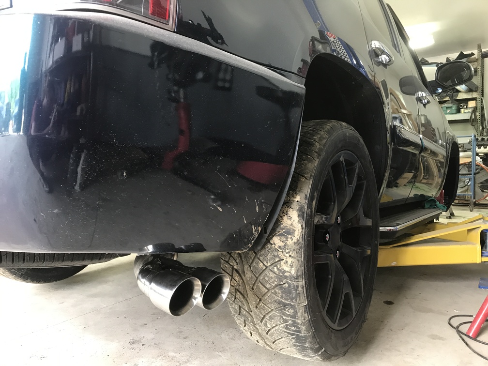

I like the wheel setup. Not usually a fan of blacked out wheels, but in combo with your paint and the chrome lug nuts it looks awesome!
