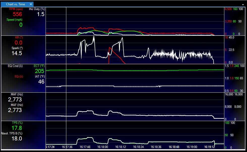

Just a generic little obdii to read codes but I have hptuners. I'll try hooking that up to see if I can find anything else.
