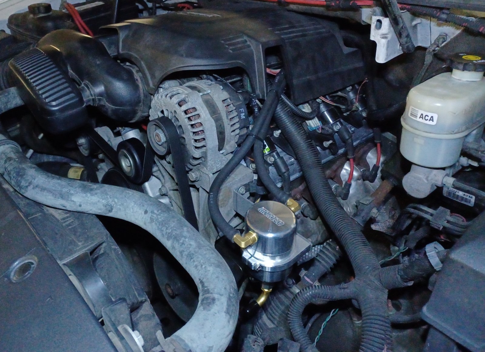

Oil Catch Can: Initially, when learning about catch cans, I searched for further information and it seemed all was positive except some conflicting opinions about catch cans causing restriction to crankcase ventilation (not many, admittedly)--leading to blown engine/oil seals. As I mentioned earlier in this thread, I do have a small but active oil leak visible at the bell housing (likely rear main seal) to begin with, so that restriction possibility raised a concern for me. Have you had any issues with oil pressure or crankcase ventilation restriction since installing your catch can?
Also, have you found any modifications were needed for the 'clean air' vent on the passenger side, or any other areas of the engine, as part of the catch can install?

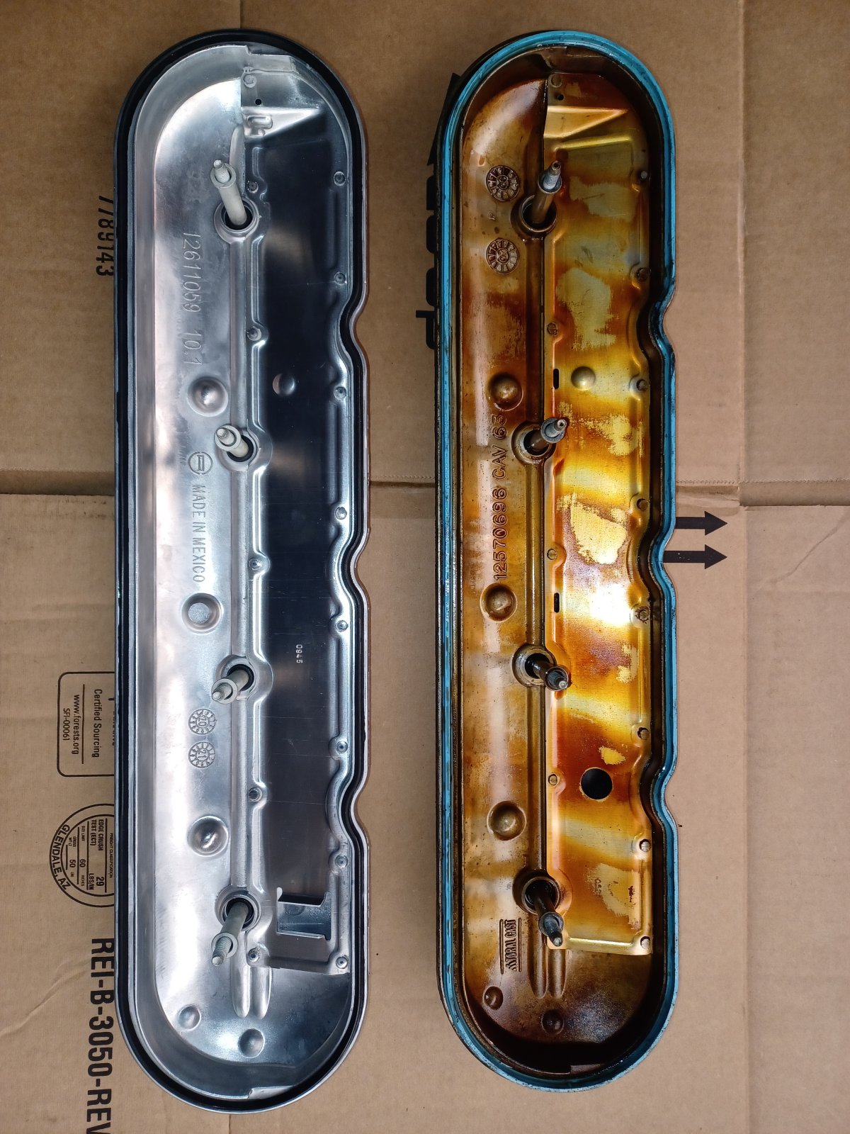

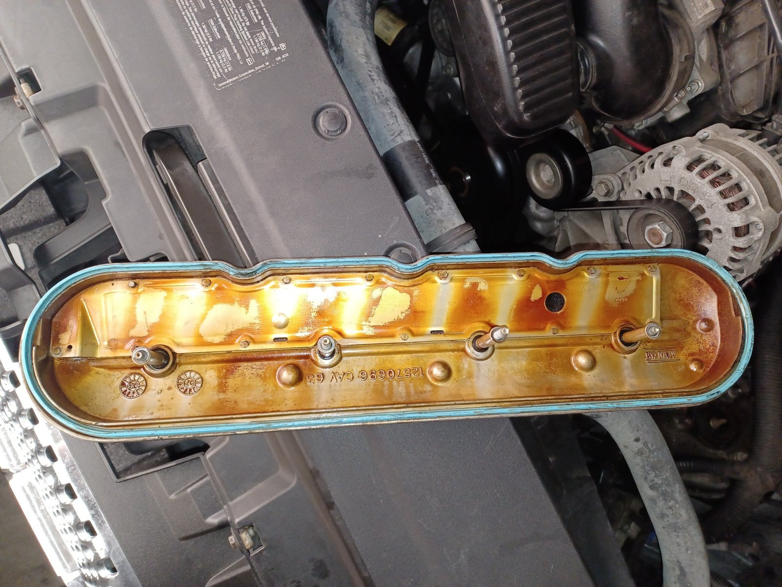

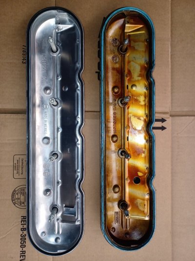

Updated Driver Side Valve Cover: (in reference to earlier in this thread) My mechanic did not update the valve cover and I have not been able to confirm any service records indicating this work was done. It looks like I will have to remove the valve cover to know if it's the updated one or not. I don't have any associated trouble codes or blue/white smoke from my exhaust and by taking a piece of paper and applying it to my open oil dipstick tube while the engine is running, my PCV has a negative vacuum (if I am understanding this correctly? the paper is lightly suctioned to the dipstick tube). All of this is to say there's no overt indication to me that my valve cover is causing a problem beyond what an oil catch can would theoretically solve.
If I do change the cover to the updated version, will it be necessary to drill out a larger weep hole (where it already exists right near the PCV valve) and/or drill more holes in the chamber leading to the PCV exit for any sloshed oil to drain from? I have seen many people talk about this, and my concern about updating the cover would be causing a problem where there currently is not one.
Example (edit: I know this guy is a bit confused about the old and updated valve cover differences, but this video explains and shows the drilling modifications the best way I've seen):

3. How does this intake modification affect the use of an oil catch can from your personal experience?
-increased likelihood of oil leak or crankcase restriction?
-any other modifications needed to accompany the OCC for it to function optimally (aside from the steel wool you and others suggested)?
They are not related nor connected, so they don't affect each other. The intake duct DOES have a hose that connects to the PCV nipple on the passenger side valve cover. This is a fresh air INLET for the PCV system. A catch can goes on the nipple on the driver side valve cover that is the OUTLET for the PCV system.
As for the catch can itself, there is no need to modify it other than to increase its filtration efficiency and, if it doesn't come with one, adding that scrubber pad is a cheap and effective way to do so.

Not having the updated valve cover makes an OCC more necessary. The updated valve cover keeps the oil inside the engine. The OCC catches what makes its way out of the engine and stores it in a reservoir where you'll have to drain it. The updated valve cover should be your first line of defense since it keep t the oil inside the engine so the OCC will only have to catch the smaller amount of oil that still gets past the updated valve cover.
A pre-existing oil leak isn't a cause for concern when referring to the updated valve cover or OCC. If this leak you speak of is from the driver side valve cover gasket or bolt grommets, then it can be remedied when you update the valve cover.
5. If I do the valve cover update, should I modify the (2010-14) dr. side valve cover or is it okay in its stock form, considering I am not experiencing any overt symptoms of oil burning in my exhaust with my current, unknown valve cover?
There are no modifications necessary to the valve cover.

It's good to know I don't have to potentially disfigure an OEM part (valve cover) for it to function. Bearing that in mind, I guess I'll start with the OCC and valve cover first.
GM realized they had a flawed design in the original cover, updated it and made it a standard part going forward. You only stand to gain by updating yours.
It's probably unnecessarily expensive, compared with cheaper options, but I like the Moroso model #85481--looks sharp and comes with a petcock valve for easy draining.
I agree that the Moroso is expensive when it performs the same function as those that cost 1/10 the price. But, those cheaper options have been known to have sub-par components, such as carbon steel baffles and/or hardware on the inside that would quickly corrode. You can do some research and find "good" cheap ones. But, if your time is more valuable and you have no problem spending the money, you're guaranteed a quality part with that Moroso and it has a bracket and hoses designed specifically to fit your engine.
