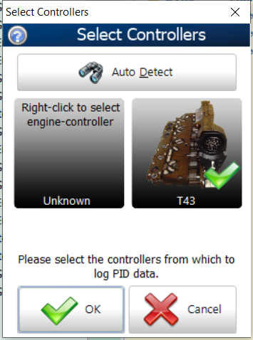

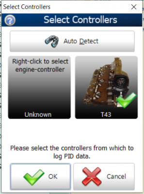

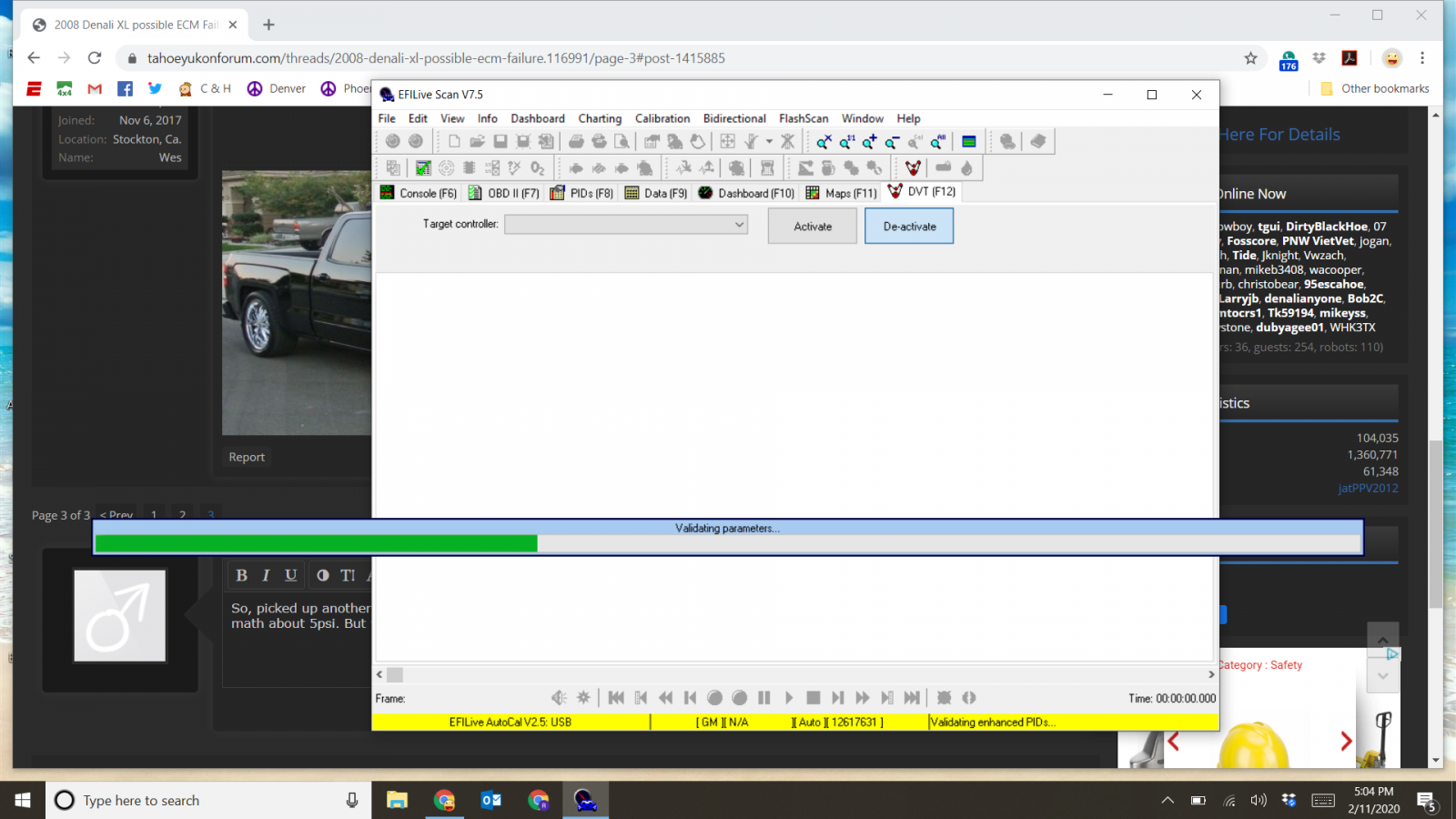

In efi live dvt commands there is a fuel pump duty cycle, but the dvt isn't giving any normal responses.
I'll try and mess with it again and see if I can post some screen shots

So you have tried to command manually in tests/functions test and no response? Sometimes in efilive you have to have it on in two different places. I am not really all that great at computer shit but I get by. Hopefully someone smarter will chime in. But if you can command fuel pump check output at computer and go from there. Anti theft? May need to scan whole truck.
