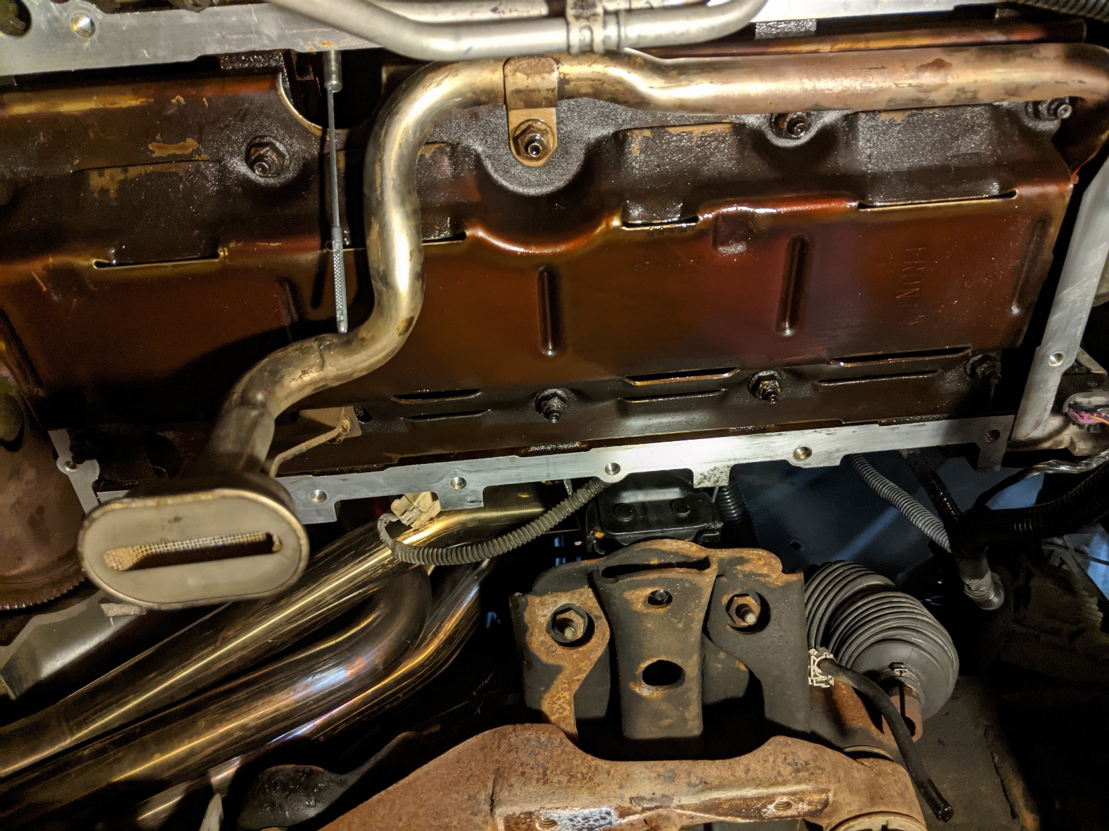

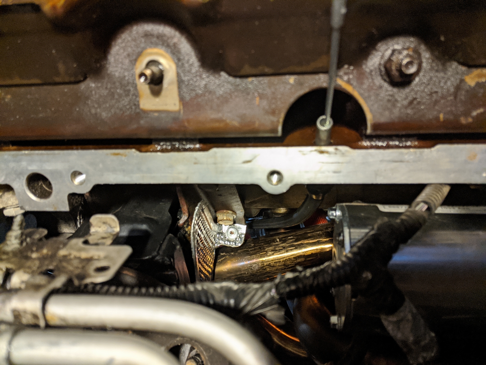

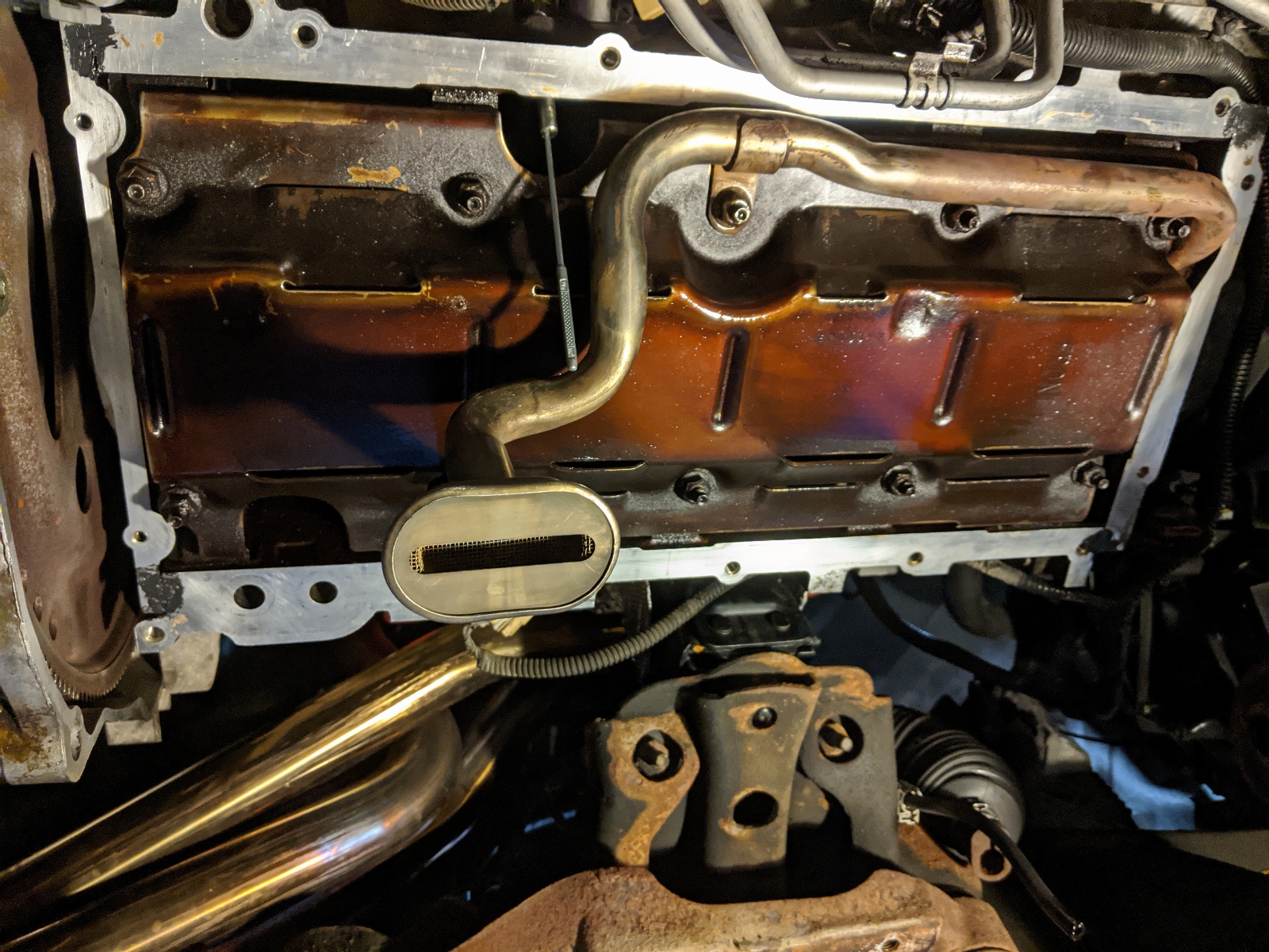

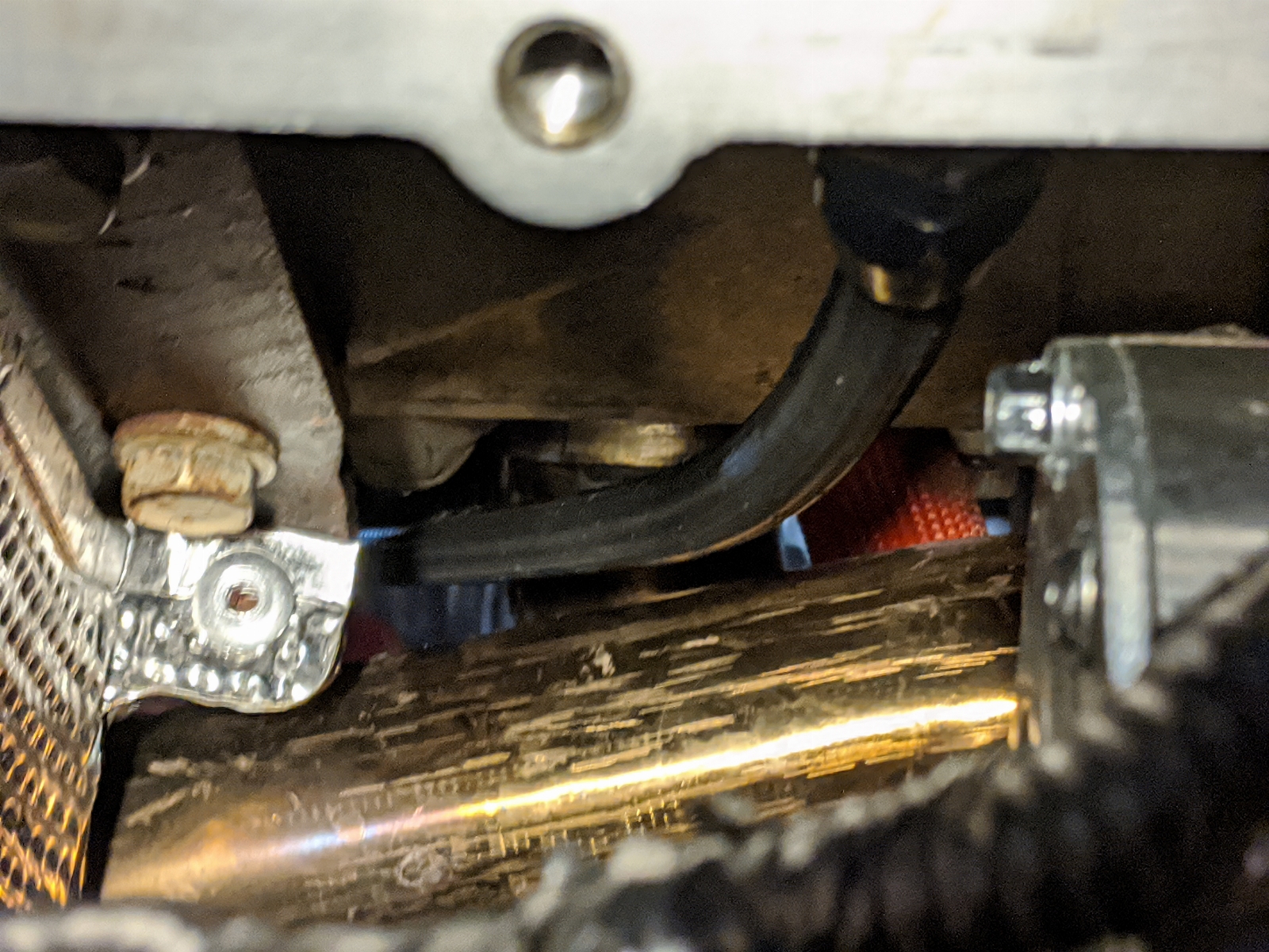

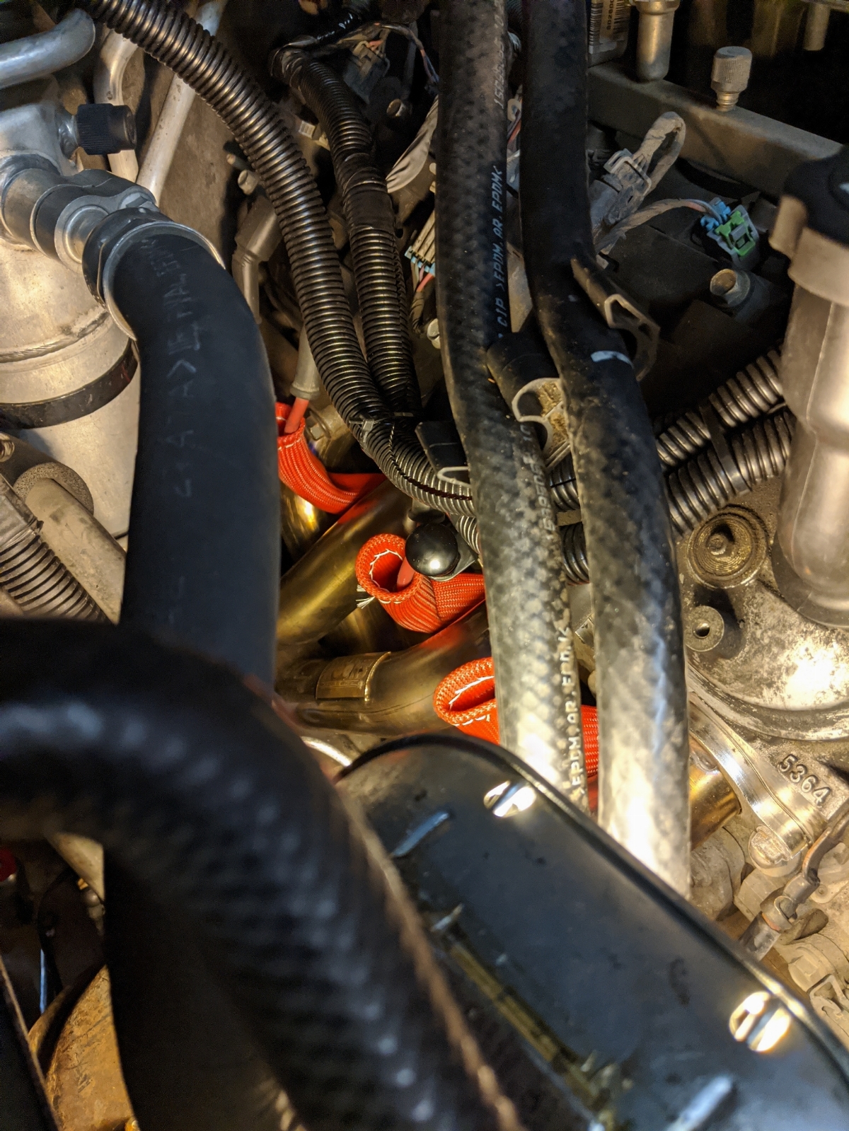

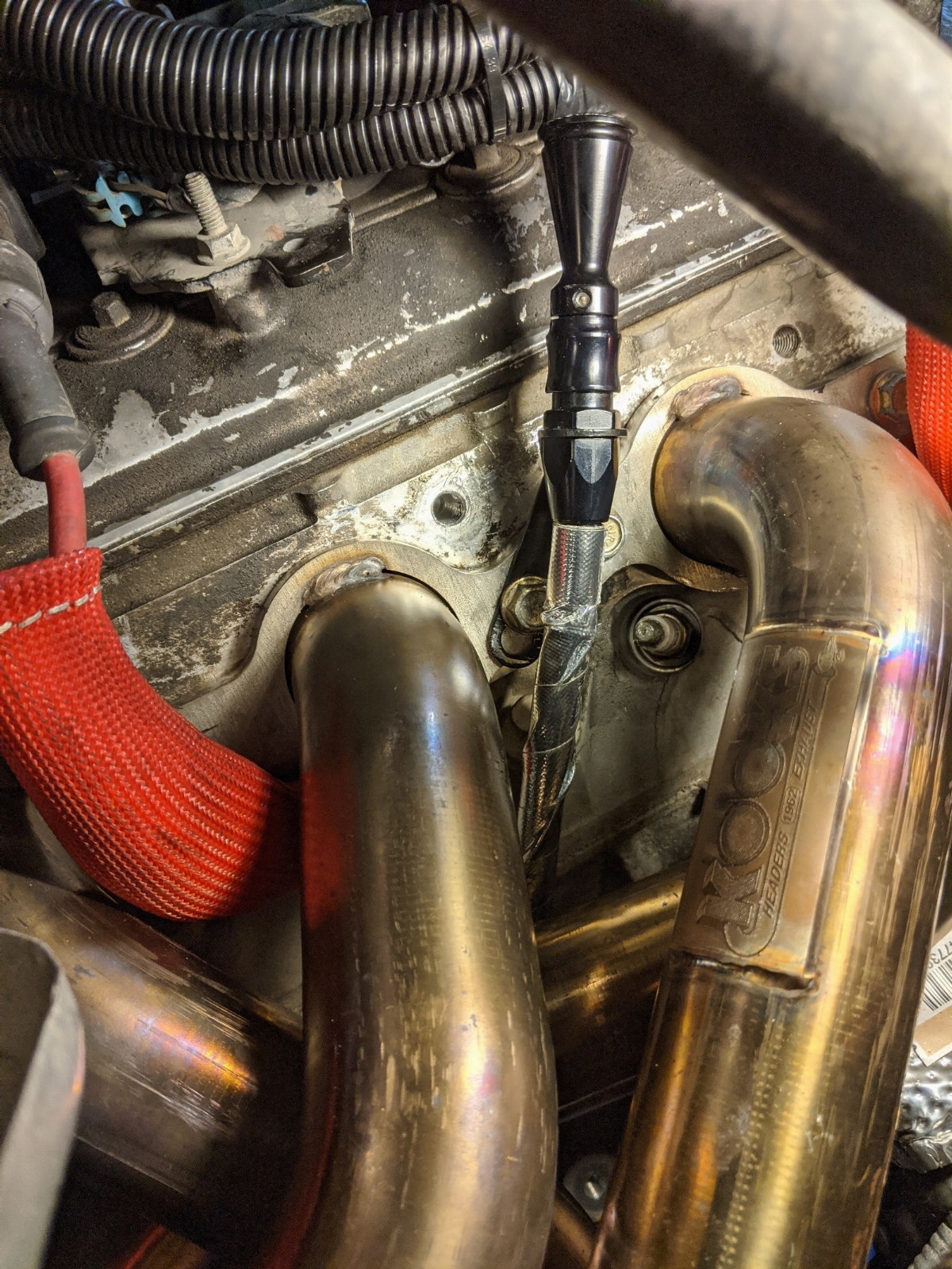

Still having issues with the drivers O2 hitting the under body. New drivers engine mount, old passengers may be an issues? I'm looking for shorter sensors or hopefully not needing to dent or cut the body.
Got a spare O2 sensor. Time to cut.
Perhaps this will give me the space I need?

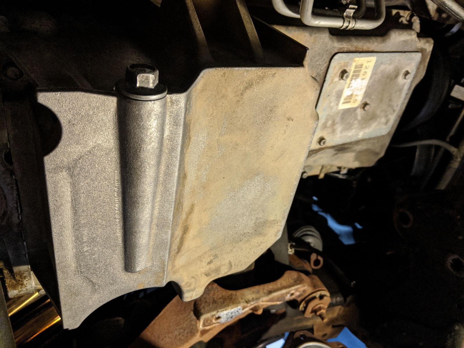

I beat a dent in. It only rubs now on 1st gear launches. I'll dent more later but at least now it doesn't hit all the time.
Driveshaft and sensor out. I used a regular hammer. The air hammer was too slow.
