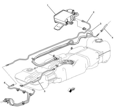

I am unable to fill my gas tank. It pretty much overflows within seconds. this started a month or so ago with it just clicking off like it was full and its slowly progressed to almost unable to get a dollars worth in with a gas can! No rough idle no check engine light either. Any help would be greatly appreciated. 2008 Yukon 5.3 ltr
Simplify it like this: The tank needs to vent, and it vents into the charcoal ("EVAP") canister. The EVAP canister vents into the engine. Find out why the tank isn't venting. A quick test is to disconnect the largest hose on the canister. I think it's the center one. If you can fill up with no problems, then the canister is clogged. If the problem persists, the issue is before the canister, so in that hose or the tank itself.
With it progressing over time, it's likely the canister or its venting system (the purge circuit) is clogged. There's a high point vent hose that runs parallel to the filler tube. Dirt daubers have been known to block that. So, when you slide underneath to disconnect that largest hose, check that vent hose that's zip-tied to the filler tube.
