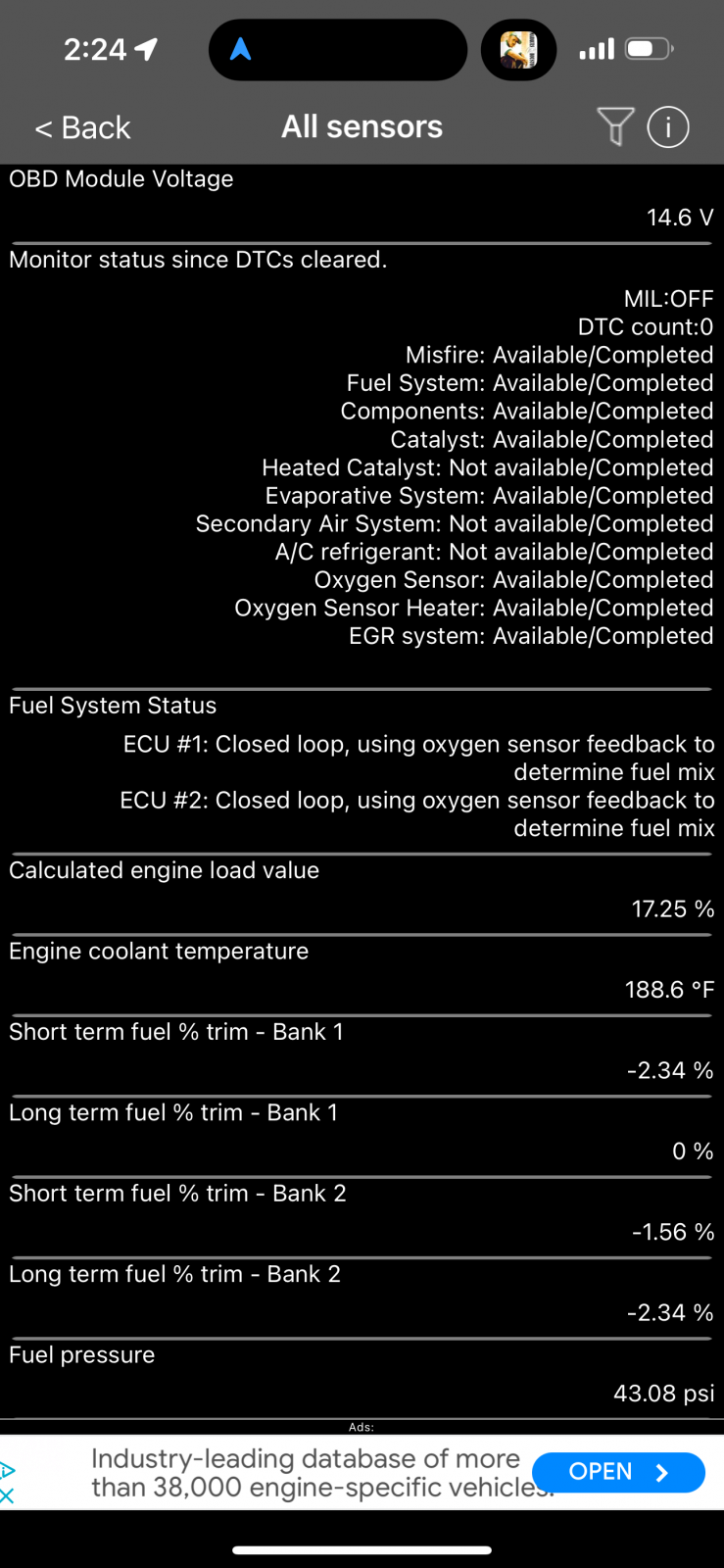

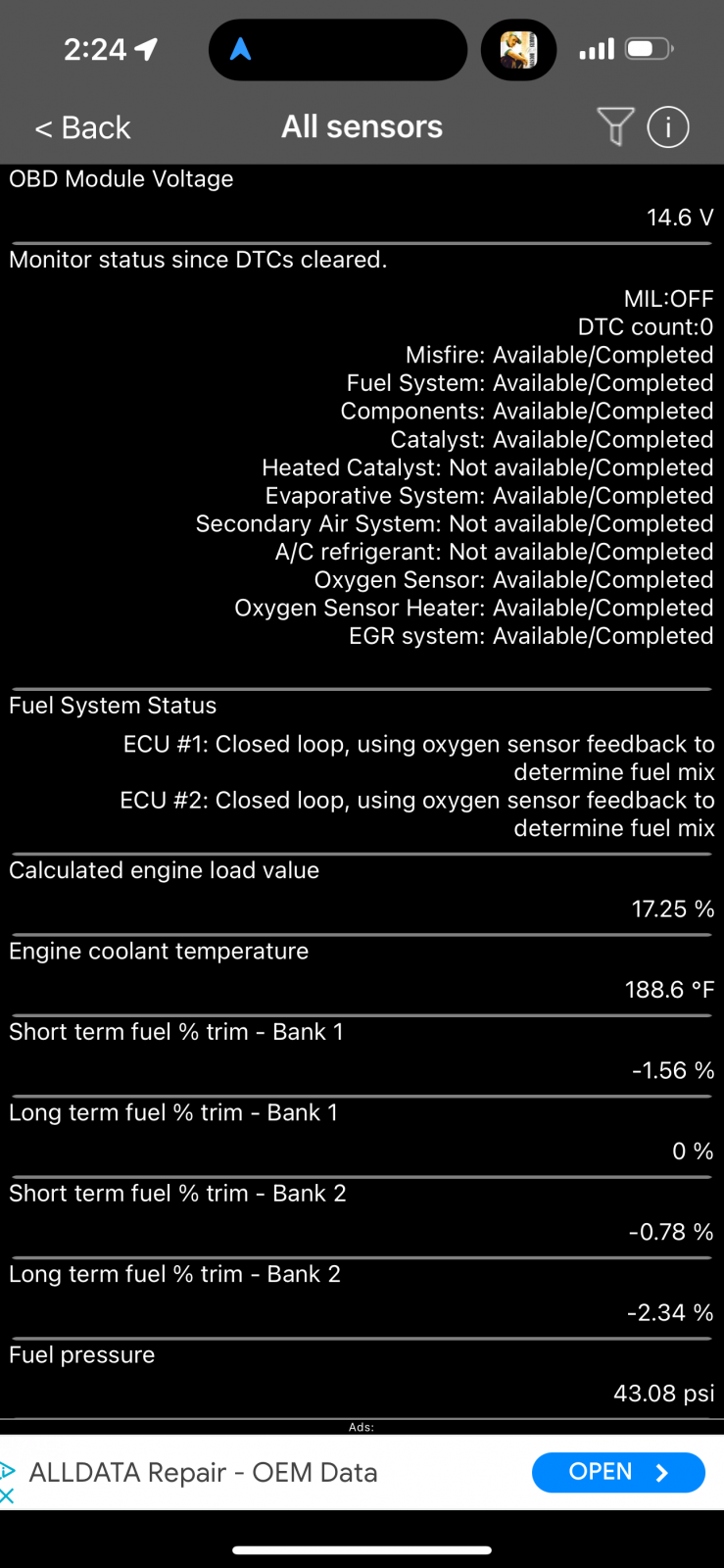

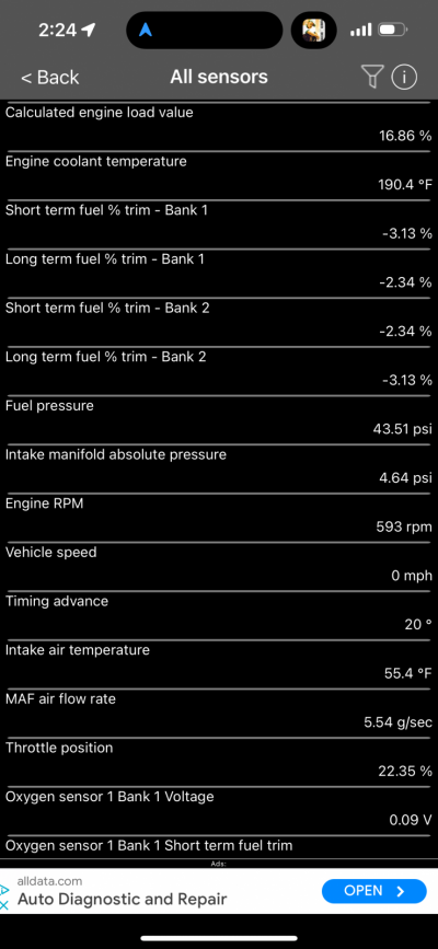

anything it tells you is probably accurate. they just don't normal have the pid info load and display. if they do, it's usually right or completely crazy if it's wrong. like it won't be off a little bit it will either work or not.
what's the fuel trims look like, long term and short term. if they arw postive numbers, that how much fuel. it's adding like say a long term of 10 is adding 10% more fuel.

THANK YOU so much for everyone's feedback. I used the scanner I had and took some screen shots. This is idling - truck had just been driven for about 10 min, then sitting for few minutes and started back up to get the values. I tried to show the fluctuation too so I took several screen shots.

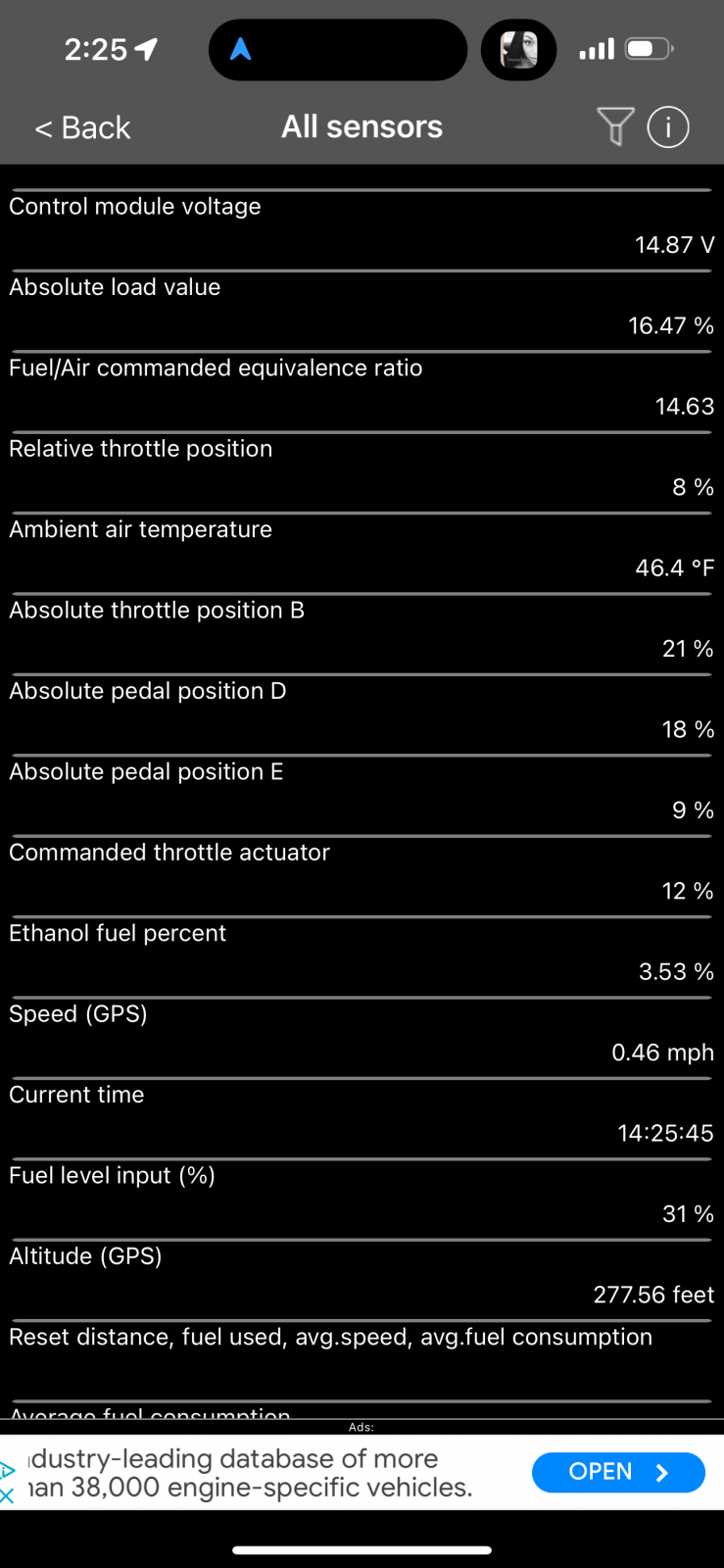

Here is more.
