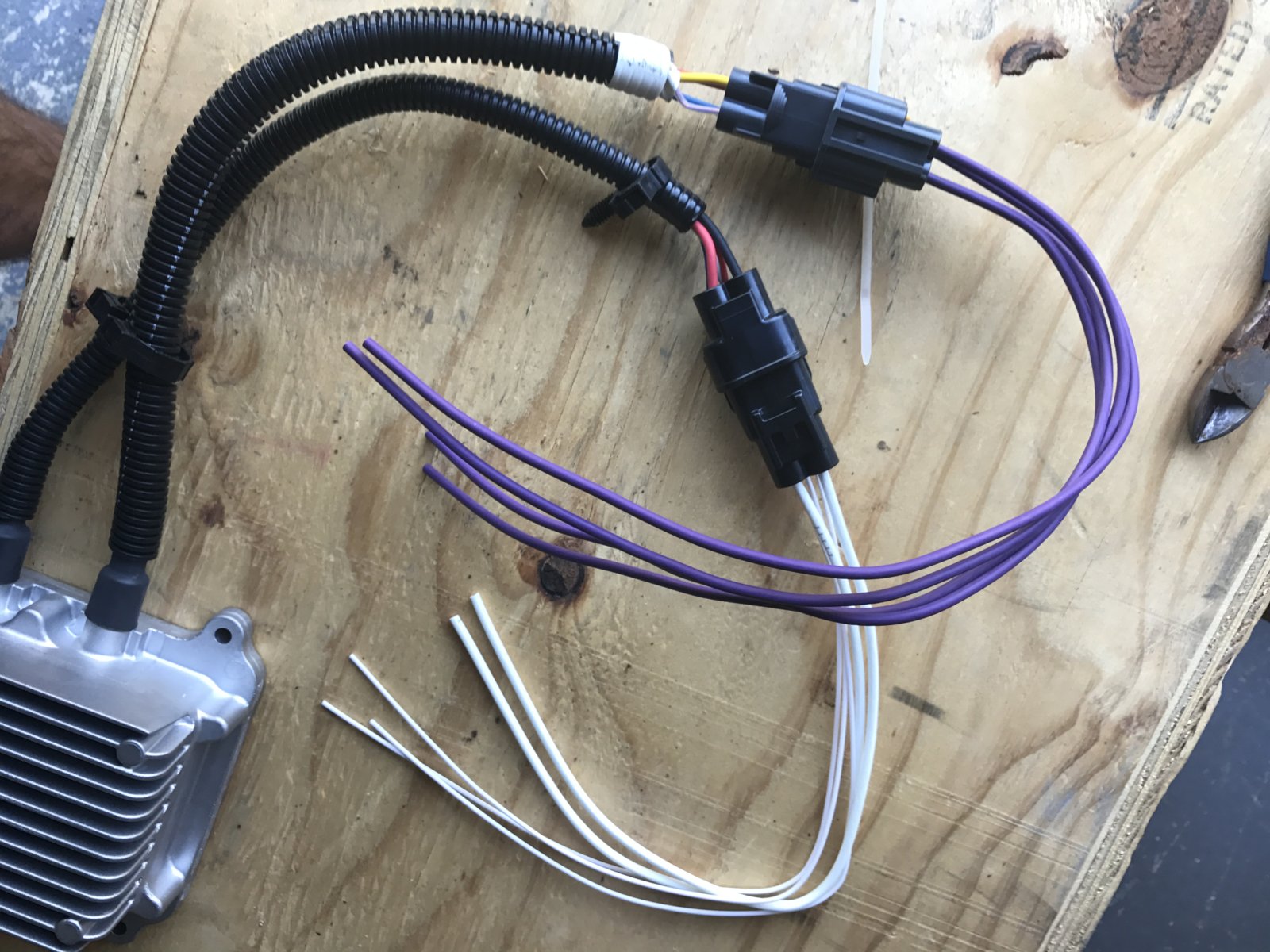

I went through this during the summer with the 2008 as well. After many hours of research and working with the dealer, I replaced the Hybrid Transmission Control Module in the front of the engine bay, located under the battery. It was about $500 for parts only and I did it myself. You’ll need the module plus two new harnesses. (Unfortunately it’s pigtail only and you have to build your connections yourself, and it is NOT a wire for wire swap!!!). I changed the harnesses and module in under 2 hours. The truck had to relearn the module for a few days, doesn’t go into auto stop during this time. It has worked and never stalled on me since. It’s not an easy job necessarily due to the dumb harnesses. The hybrid guy at the local GM dealer had never replaced one himself so I had to do everything myself. But I promise it’s the solution.

i got the part number for it 24261817 is the newer part #
What year are you converting from ? No chop kit
No sales tax :D estimated cost 292.48 including shipping and core
here is some more information on page 1 on the bottom of the page
Note: If ordering a control module for a 2008 or 2009 MY vehicle, also order connector p/ns 24259589 and 24259590.
Note: If ordering a pump for a 2008 or 2009 MY vehicle with the original control module, also order connector part number 24259588.
Note: If ordering a pump and control module for 2008 or 2009 MY vehicle, also order connector part number 24259590.
No chop the connectors!
