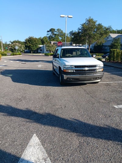

Neither... my interest rate nearly doubled the price of the vehicle. I ended up buying a 2005 tahoe, with only 2 owners for $5000. It has been garage kept with original paint and the oil was changed every 2500 miles. Undercarriage is clear of rust and clean. 202k miles and I could eat off of the engine, it's that clean. Still has the Jerry Hamm Chevrolet sticker on the back from which the truck was purchased with 4 miles. You guys really made me rethink buying a newer one and I am very happy yall did so. I hope I can get this beauty to 300k miles.

Looks to be a Z71?
The only issue I think you MIGHT have is the white trucks were known for the paint peeling.

Score! It’s a 300k drive train & chassis. Get ready for the boring maintenance stuff like fuel pumps and hoses.
Focus on a front end rebuild in the future, the kind where you get the parts from RockAuto and an Indi tech installs them. You’ll get a truck that drives better than when new.
