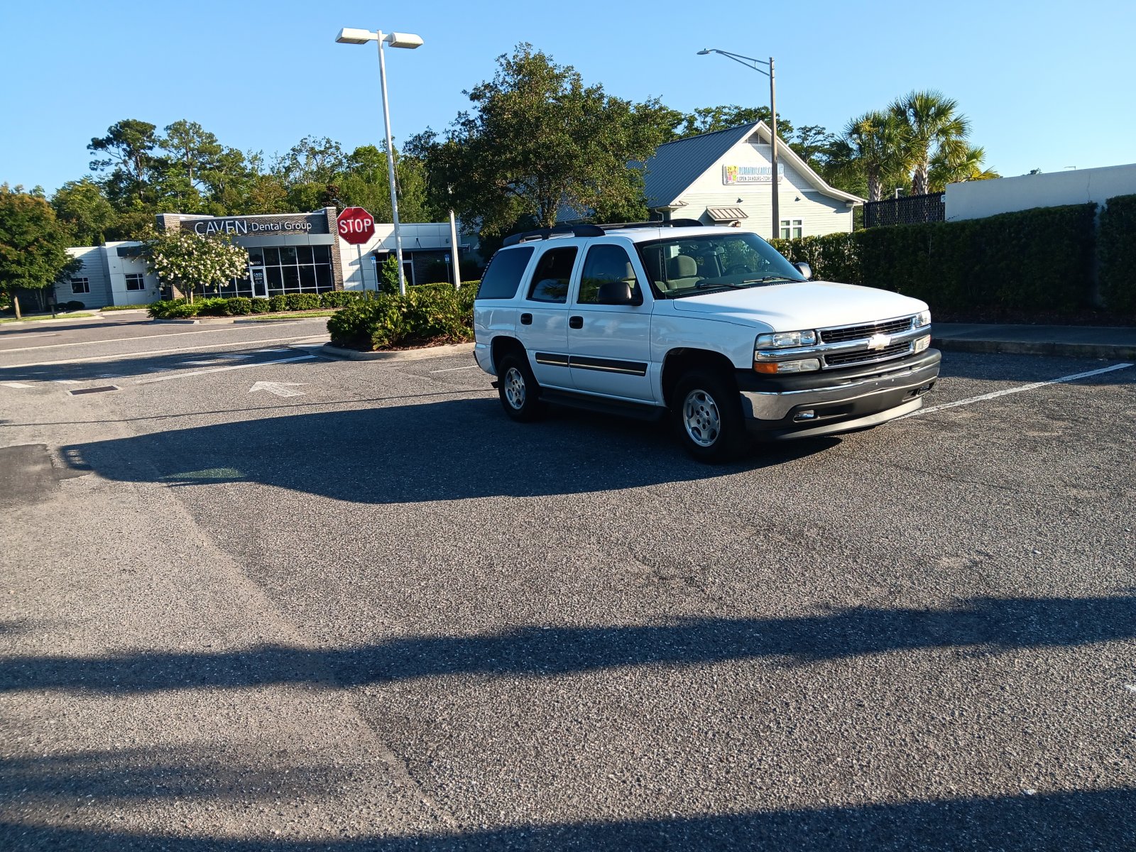

Both trucks look well used on the inside with the white one seeming slightly better(?) Plus, the white looks better in my book.
Or, do a search for 2007,08,09 Escalade or Denali to see what comes up. You might be surprised

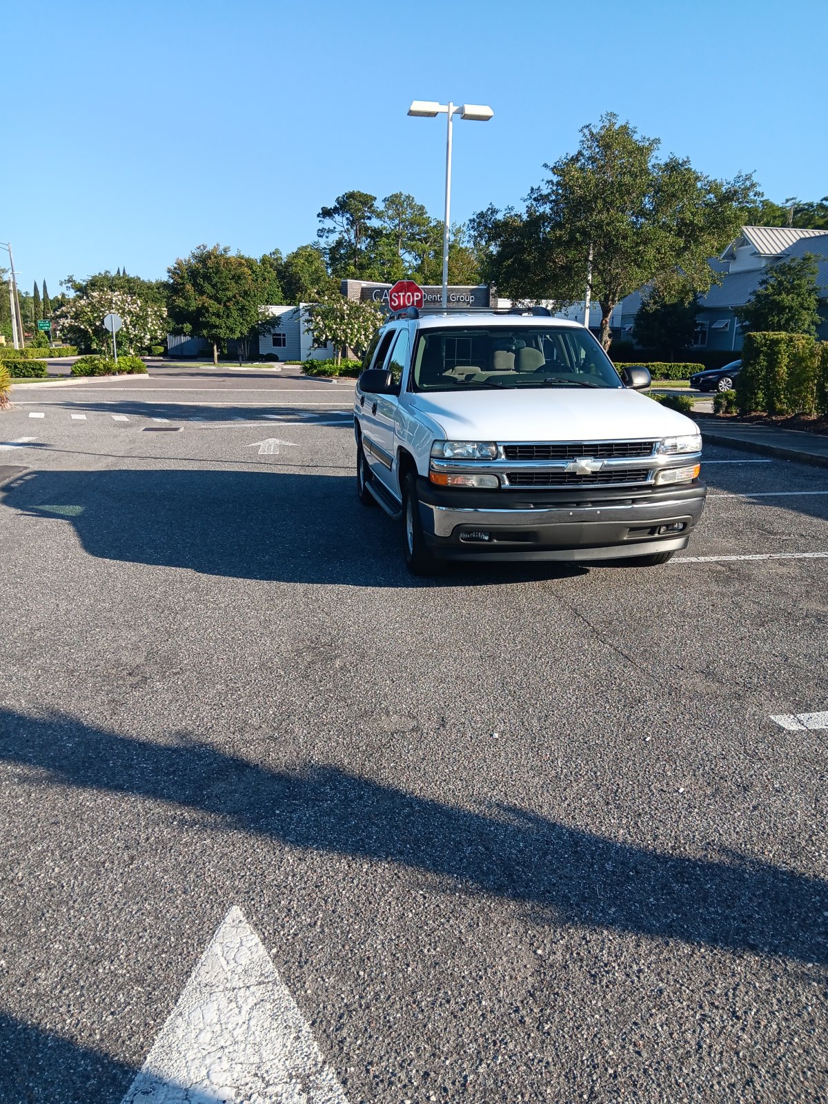

This one is a bit of a drive at 150 miles away, but IMHO, a better deal over all.
I will always buy a 2003-2006 GMT before I buy anything newer, or older. Last years of near absolute bullet proof trucks
