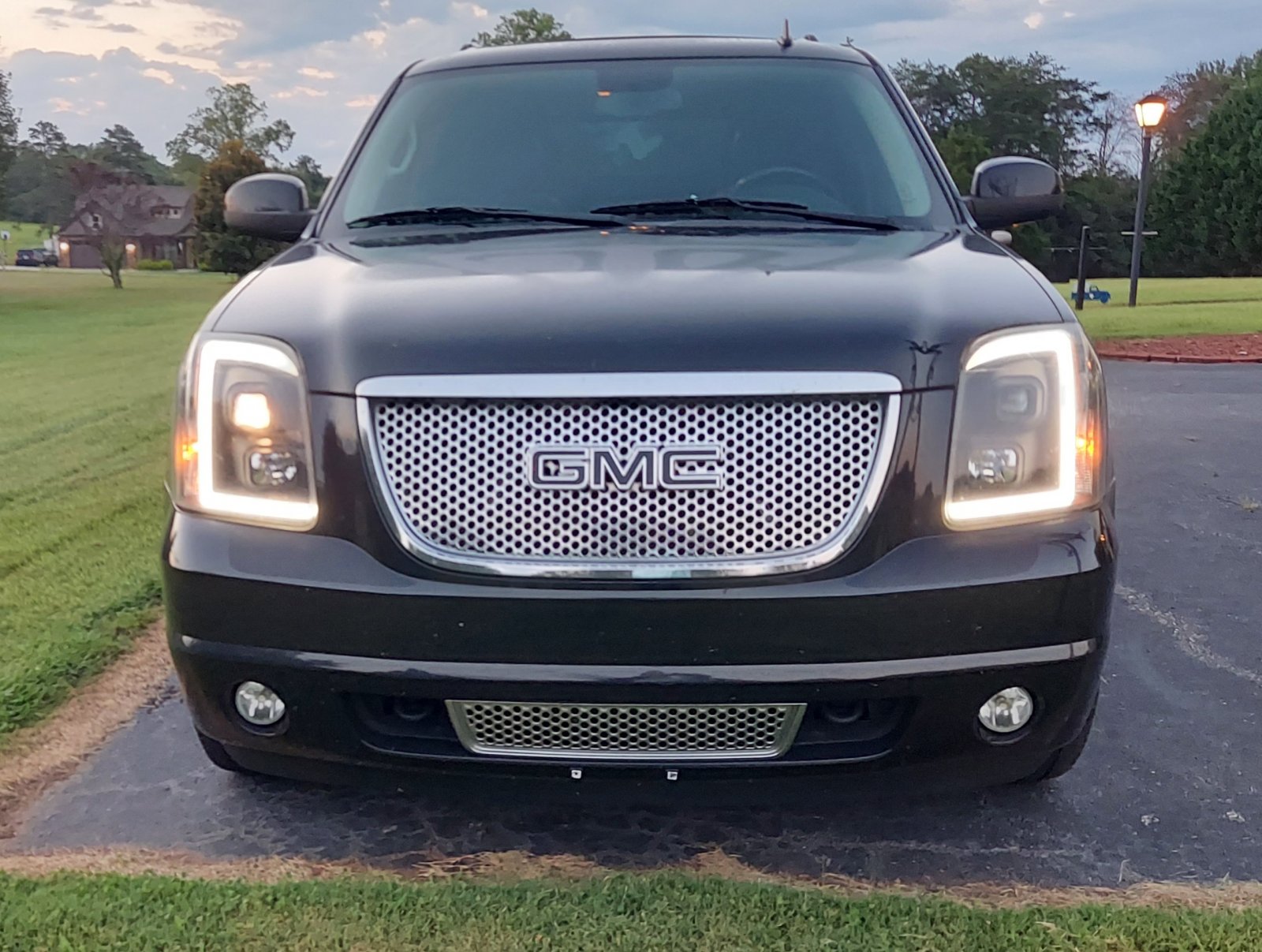

These are probably going to be out of your price range - but I HIGHLY recommend the Morimoto XB LED replacement headlights for the 2007-2014 Yukons:
I replaced the stock yellowed and cracked OEM housings with these about a year and a half ago - and they're great. Awesome beam pattern with a great cutoff - LOTS of light - nice color on the light - etc. I had tried a number of different bulbs in the OEM housings and was investigating putting in new OEM housings with some sort of LED bulbs - when I saw that these came out. They've got a nice DRL in them too. I thought they were expensive when I got them - but after driving with them for a while I think they're worth the money. Probably the best headlights of any car I ever driven - and that includes some Lexus and Acura models with the reputation of having really good headlights.

They definitely look nice. I wish they came in the OE chrome finish and didn't have the "LED" insignia.
I'm considering them, and I would already have them if they didn't only come in graphite. Not sure how they will look with the white diamond tri-coat.

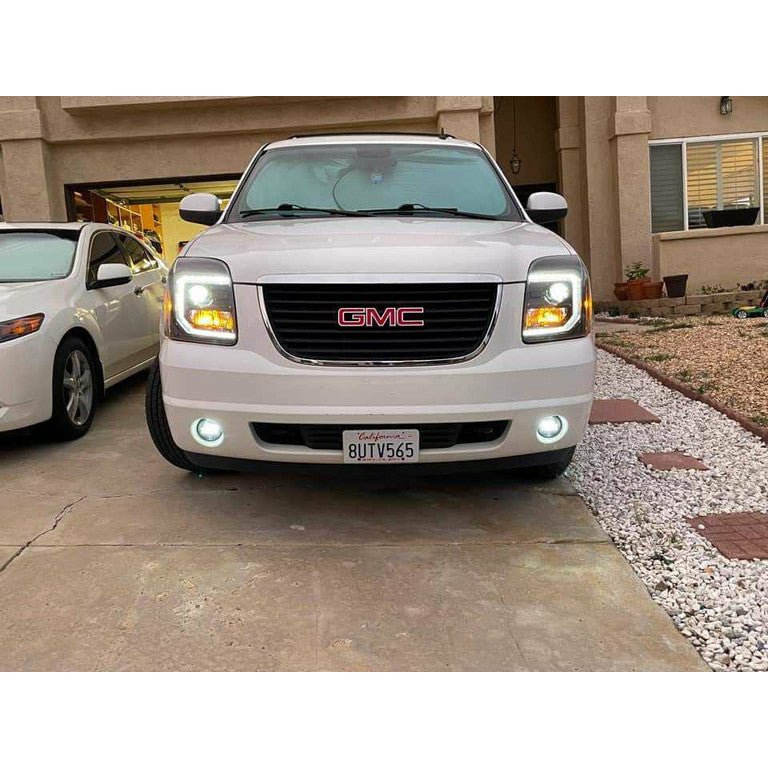

They look pretty good on my 2010 Yukon XL in silver - I think there's some pics online of what they look like on a white Yukon
