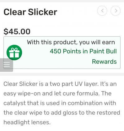

Out of curiosity, has anyone ever tried a coating on new lights to slow or prevent the fogging- a clear coat or something?
I still think someone should be making a lense cover of glass.
