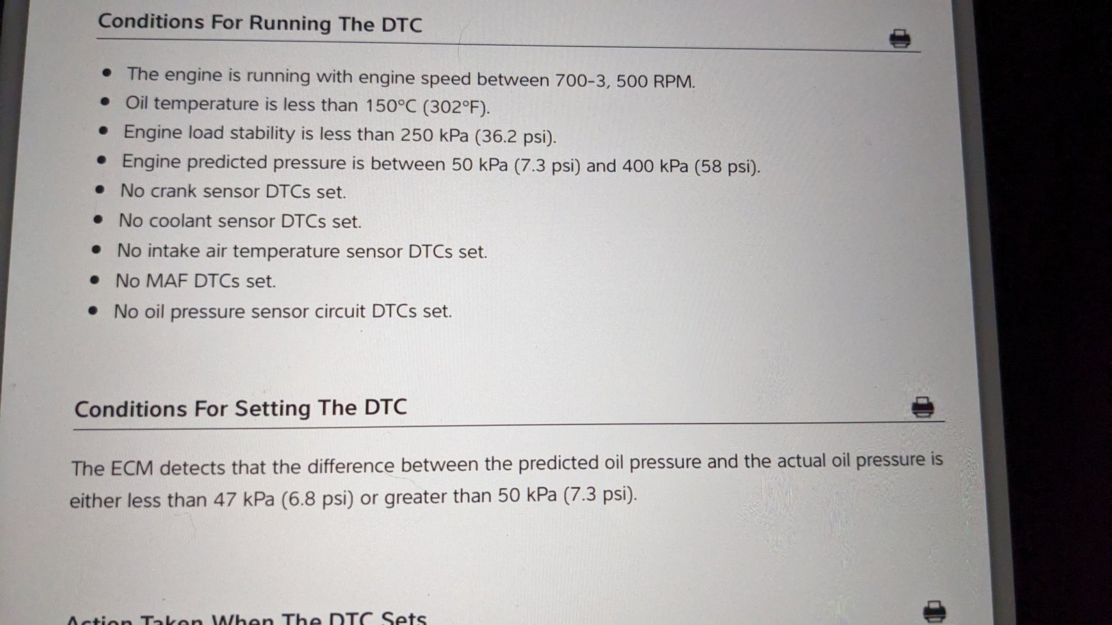

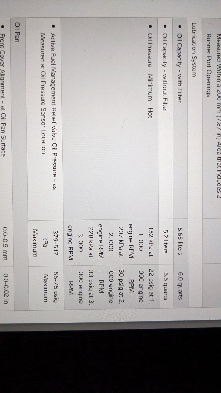

Dangit, I've been curious about our oil pick-up o-ring for a couple of years because of posts on this forum. Current readings are 25-30 psi at idle and almost 40 at hightway speeds. Two mechanics have advised me that the o-ring is not the problem and said that the low-ish oil pressure was because of the car's mileage..."don't waste money an an o-ring replacement". Ugh. Replaced the oil pressure sender, no change in the reading.
