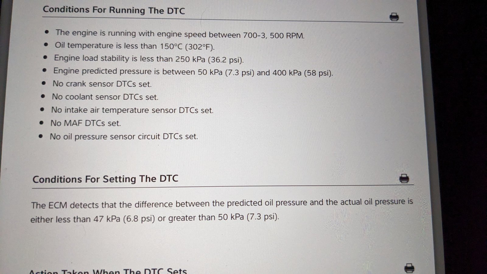

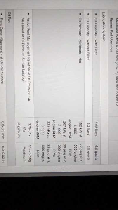

Dangit, I've been curious about our oil pick-up o-ring for a couple of years because of posts on this forum. Current readings are 25-30 psi at idle and almost 40 at hightway speeds. Two mechanics have advised me that the o-ring is not the problem and said that the low-ish oil pressure was because of the car's mileage..."don't waste money an an o-ring replacement". Ugh. Replaced the oil pressure sender, no change in the reading.
(Apologies, off-topic for this post, I know...)
without looking it up, I think that's well within what gm calls for hot temp oil pressure by rpm.
but I believe the simple test is find a steep drive way or something like a loading dock. back up it and see if your oil pressure goes up. you just gotta cover the o'ring at the front of the engine so it doesn't suck air. I've heard a few extra qt of oil will do it too, pick up some cheap oil before your next oil change and add it in. go check to see if you have higher pressures. but again, check the specs, I'm pretty sure that's good to go. don't leave the extra oil in for long or high rpm.
edit.. I believe this was a 2010ish 5.3 with afm specs. and the ecm allows for 6psi below that for setting a light.
doesn't take much oil pressure to cruise around town, but sucking air and it foaming isn't great for it.
