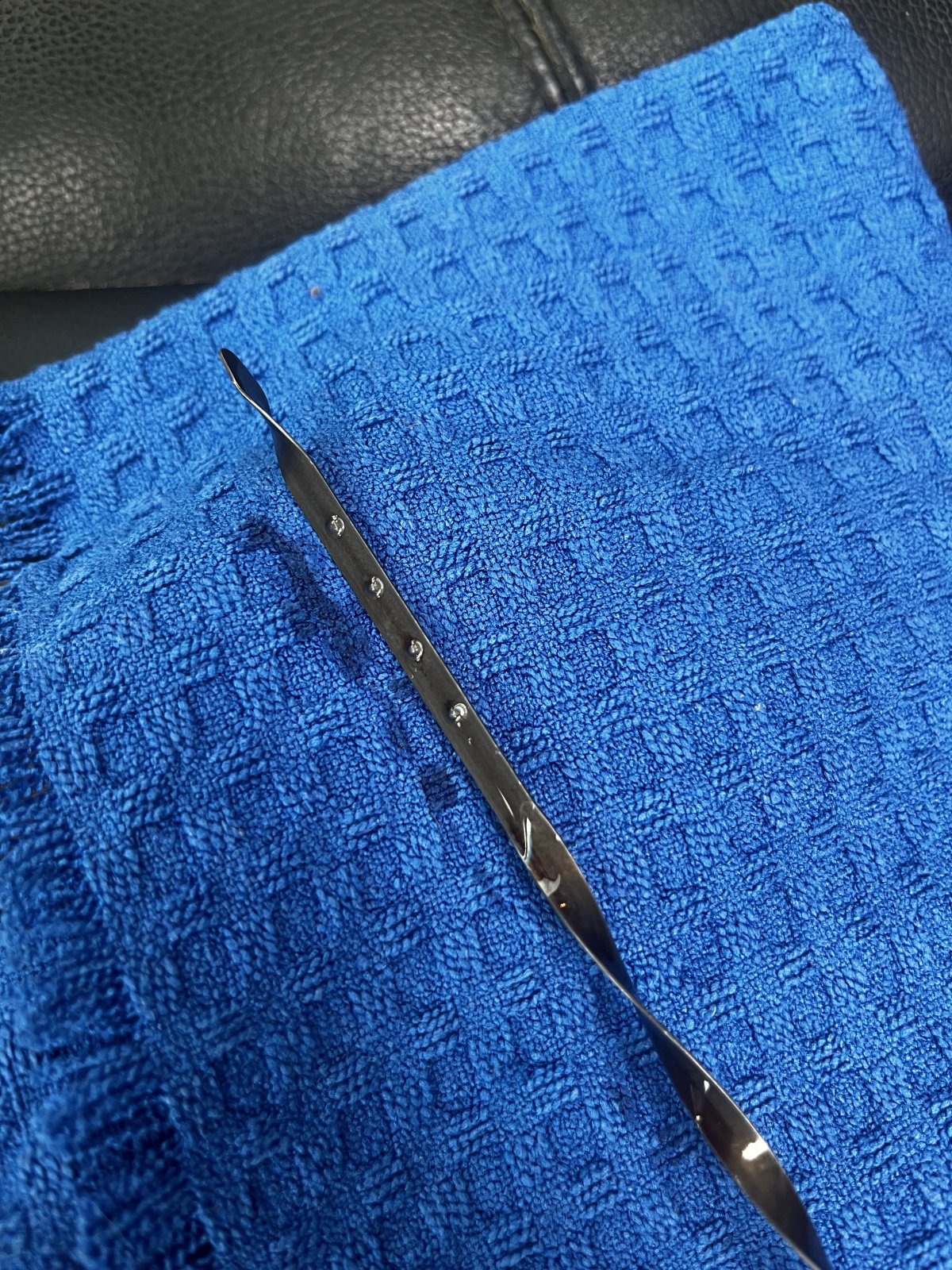

As far as the metal in the oil/shiny oil, is that something to be concerned about?
If you drove the suv long with low oil pressure you may have damaged it. That would cause the oil to have metal flakes.

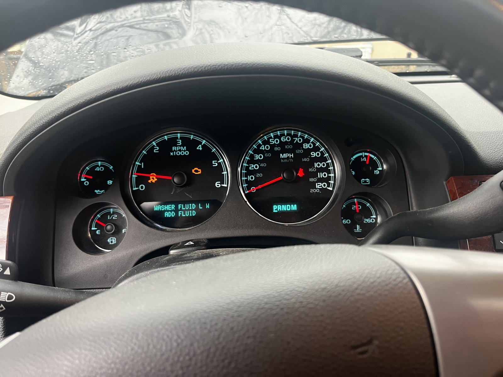

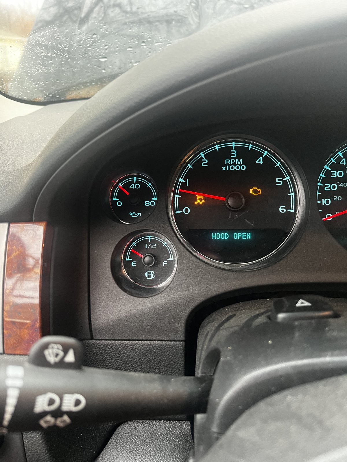

2nd- I got the low oil pressure warning at around 5psi while driving to work, but never hit 0, then the warning turned off and then turned on again a minute or two later right as I was parking the vehicle. I drove about 4-5miles to get to work once the first warning came on.

There has been a great number of suggestions here, so I have nothing to add in the diagnosis department. I would definitely do an quick look at the oil on the dipstick though. Run it for several minutes, then shut it off and wait a few minutes. Then pull the dipstick and wipe it on a new, clean white rag, or a dark color like navy blue or black. After that, check onn good light for anything shiny in the oil area. I've used dark colored shirts in the past for this and the contrast can sometimes make it easier to see.
If you don't see anything shiny, then go forth with above mentioned checks/tests.
