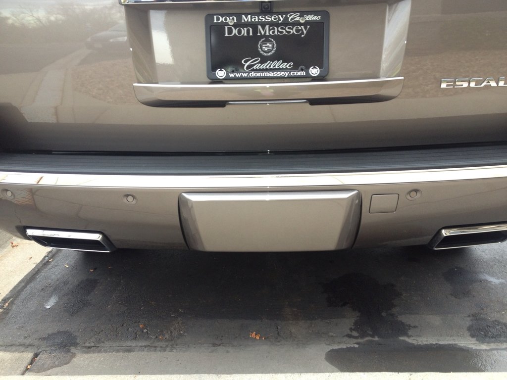

Well looks like my post is only applicable to Escalades lol...hopefully it will atleast be useful for those Escalade owners looking to do the swap....Congrats to the other NNBS models for a way easier conversion!!!

Two questions
1) If I leave the exhaust stock (meaning not running it to the cutouts on the bumper) can I just bolt on the bumper leaving the spare in place? Or will the dual exhaust extensions themself hit the spare?
2) How visible is the stock exhaust with this bumper? Can I get away with leaving the stock exhaust on or is it as visible as it is with the stock bumper??
Oh and also, does it use the existing brackets from the tahoe to mount to the truck or do you need different brackets??

You'll see the stock exhaust and it'd look bad. Why would you bother with it if you were just going to leave the exhaust stock?
I can't be without a spare.. I would eventually do something about the stock exhaust but it would probably stay stock when/if I first do the bumper

Two questions
you could dump the stock exhaust, no one would know the difference.
You can hardly see the exhaust pipes inside those tips.
This is true but in the winter when it's cold it'll also look silly seeing the exhaust coming from around the rear axle as opposed to the exhaust exits.
IMO if you can't run without a spare skip the dual exhaust bumper but that's just my opinion which doesn't mean much.
