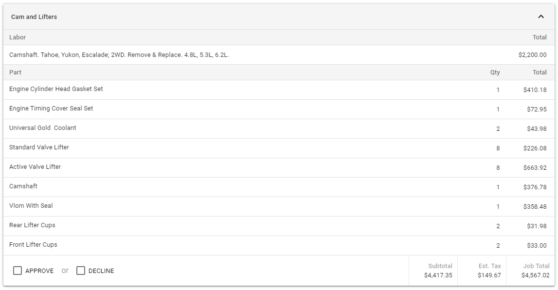

Now for the painful part. They recommend I replace the camshaft (for wear) and all the lifters, gaskets, and VLOM. Here is their quote:
Does this analysis make sense? Does a .03" difference in lifter travel enough to make a valve not seal? Any other way I can address this?

It sounds like these guys are a bit more forthcoming with the details of their diagnostics. A few things that still leave me a little cold.
A lack of lift doesn't affect the seal of the valve. Lift is opening of the valve (unsealing), if you had no lift, you can still have a perfect seal.
They don't know if you have any cam lobe issues at all. You have to remove the head to see the cam lobes. A bad lifter might be all you have going on. Replacing all the lifters and the cam for a single bad lifter is well, expensive.
Your VLOM is the updated one. You didn't have an AFM lifter problem, why do you need a new VLOM?
$2200 labor is very high for this job, even as spec'ed which may end up being a fraction of what they are quoting (if the cam is fine).
Parts - look like more than 100% markup from online retail like GM Parts Direct.
If it were me, I would keep looking for a shop. A dealer service department quote likely would come in close to this and they probably would give you a lower bound number as well, if they found that the cam was fine. If the cam turned out to be OK and it was just a bad lifter, I would likely have them replace the lifters on that bank and leave the other bank alone (i.e. not even pull the head). That job would probably be a faction of the quoted labor as well.
