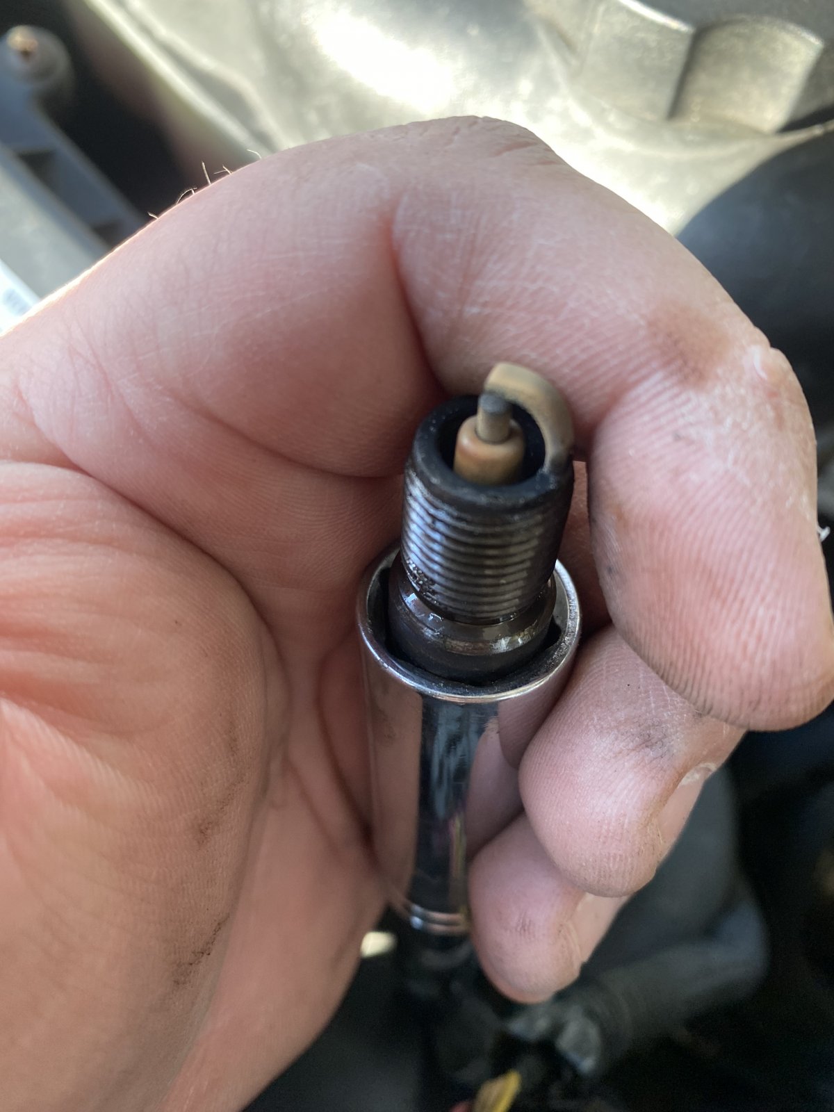

So small update. Here are the compression numbers. Now throwing codes for cylinder 5 misfire and also a p0300, bank 1 lean, oil pressure and a large evap leak. Motor bogs down bad when coming to a slow stop. When it misfires bad the engine light flashes and traction control turns off and stabilitrak turns off. The plug in the picture is cylinder 6 that has the highest compression. I’ve tried swapping plug, coil and wire with 5 and 3. It did not follow to 3. Just gapped all the plugs again. They were at .45. They are now at .40. Also cleaned out all the injectors. I did recently unplug the front o2 sensors and drove it a little bit. Seemed to have some of its pep back but was still misfiring.

View attachment 453525View attachment 453526
Ok so also found the fscm fuse had a weird like burned grease film on it. Looks like previous owner put some sort of grease in it and it didn’t like it lol. Replaced the fuse and started her up. Check engine light immediately went away. Unfortunately still idles rough but is idling at about 580-620 which is better than the 480-520 before. Also still misfiring really bad on all cylinders at about 1100-1800 rpm
