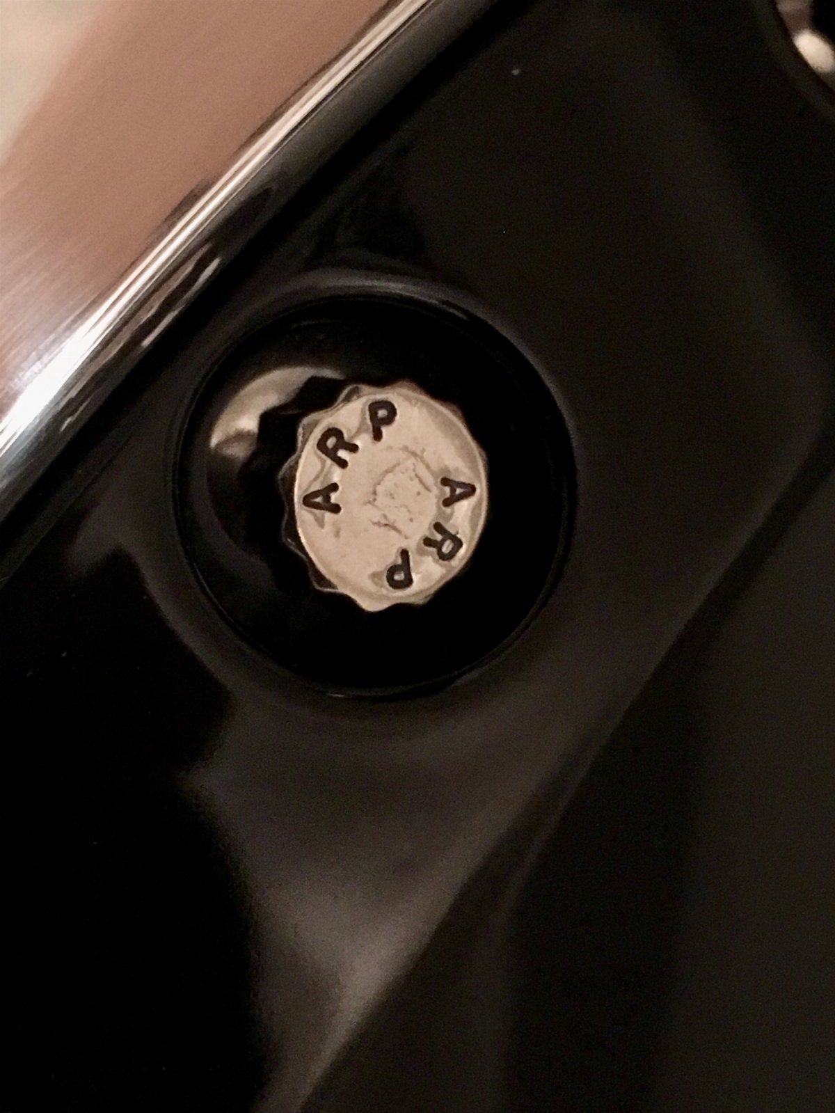

a little update...
LS3 Rockers w Straub Trunion Bushings
Circle D Billet Flywheel w ARP Bolts...

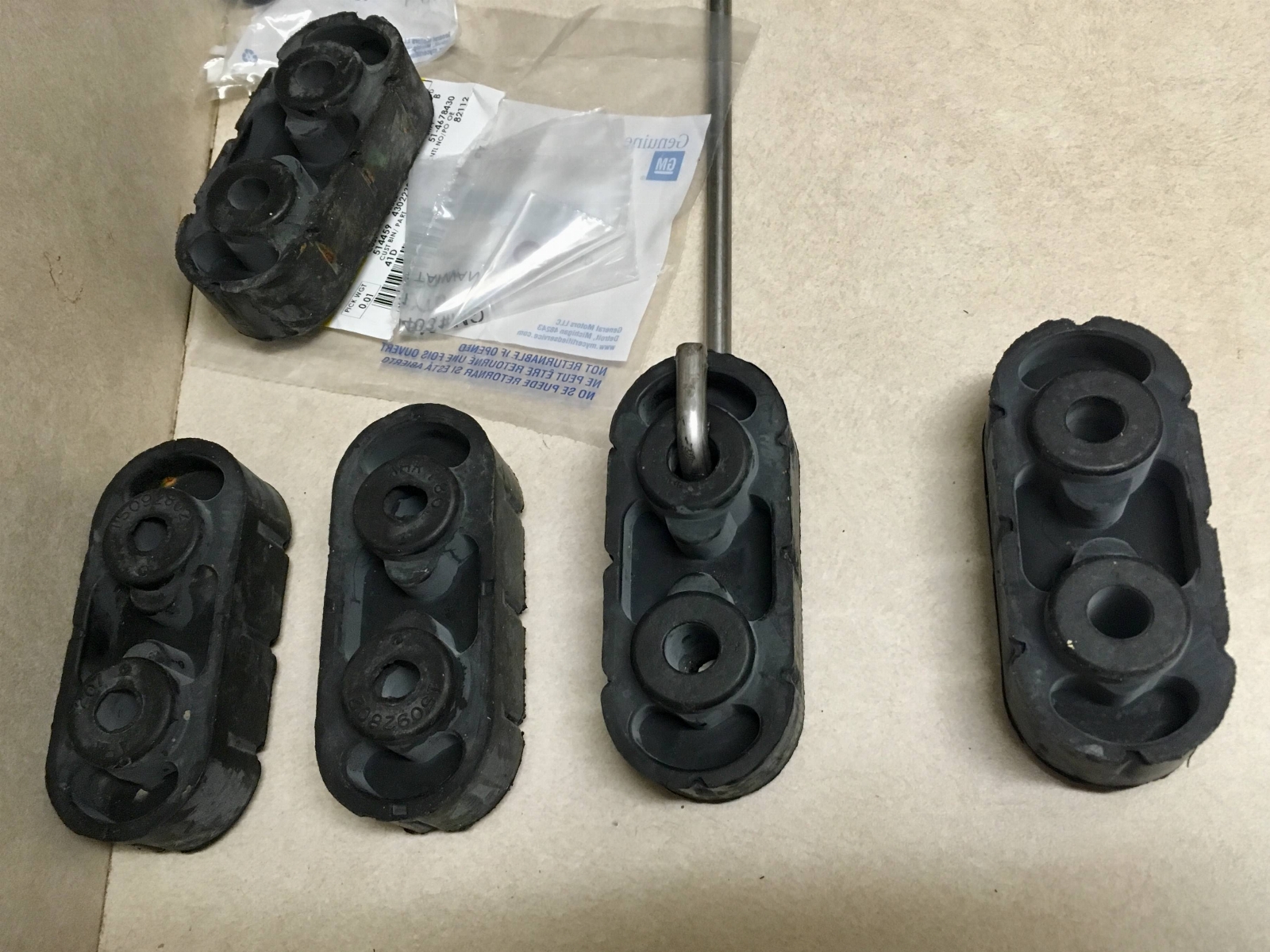

did you do the trunion upgrade yourself? i completely missed doing them while i was in there. I may grab another set of oems and get them set up just to sway
01FormulaTA
01FormulaTA
Mar 23, 2017
534
561
The Trunion upgrade was a pain in the A$$, but its worth it for cheap insurance and piece of mind...its just time consuming and tedious mostly....I did it at my kitchen table using only a vice, snap ring pliers and the Summit Trunion Tool (SME-906011), some videos show using an arbor press as well but I was able to get away with just the vice....
After a couple boring hours...
Much better than the factory needle bearings...
