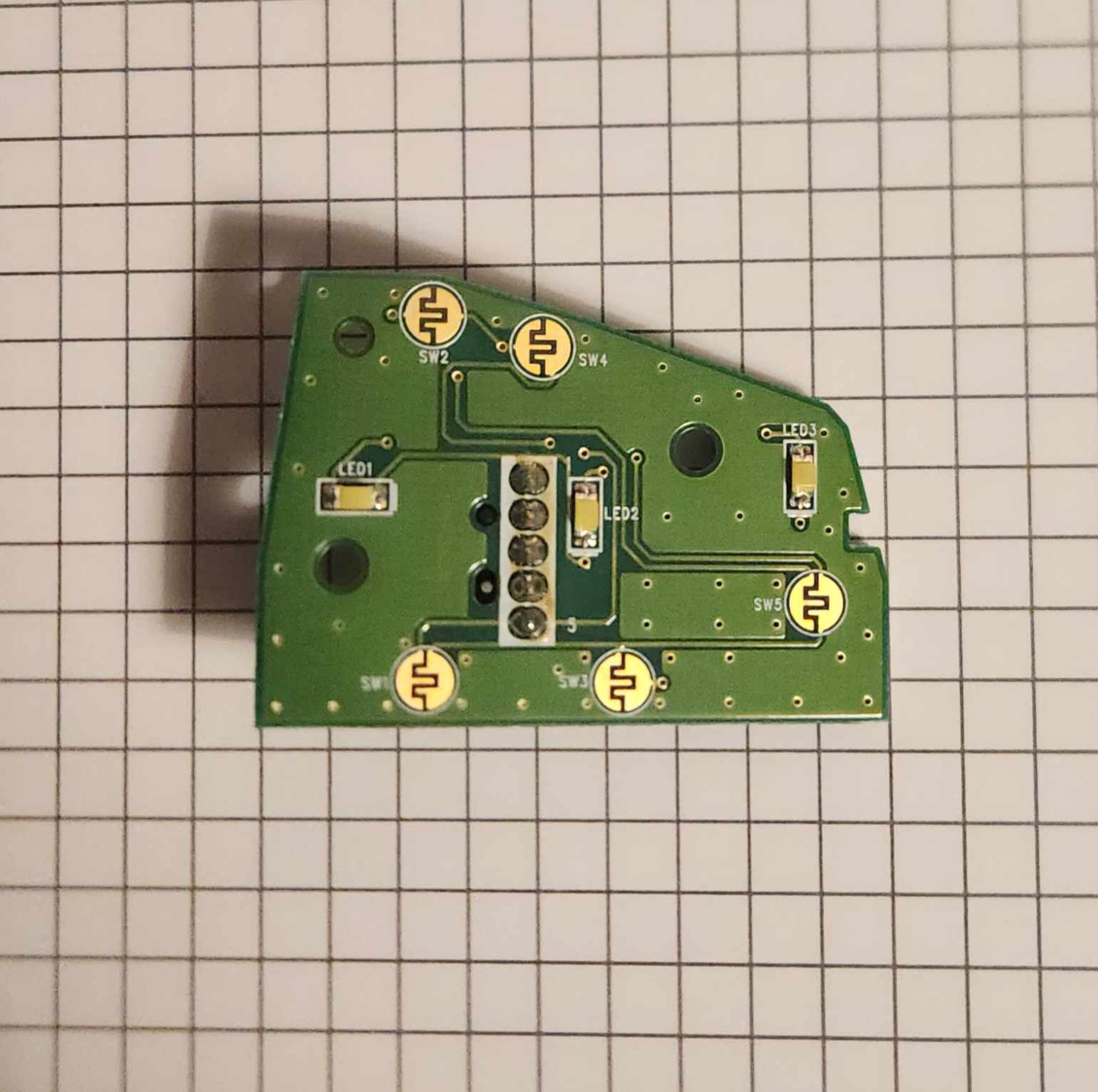

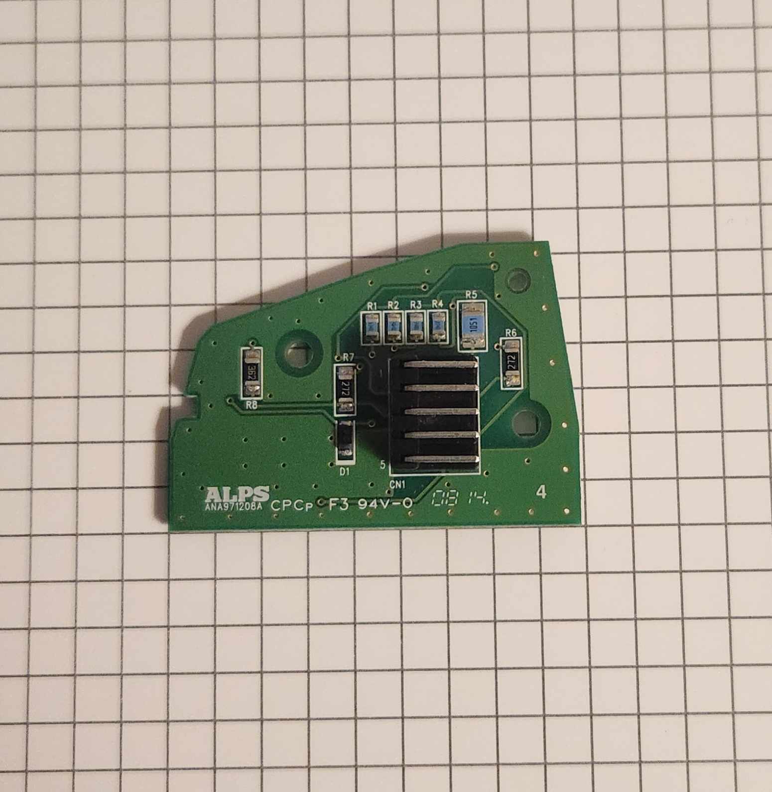

No the buttons are integrated into a circuit board along with their respective resistors. From all the research I’ve done its plausible but would require a tremendous amount of effort to pull off.
Does the actual 2013 CTS-V wheel fit on the 3rd gen Escalades, physically I mean? Just found this thread while thinking about wheel swaps for an 08, would love a CTS-V wheel with the V emblem on it; I want to LSA the truck at some point. I am more worried about physically fitting the steering column, the switches seem really straight forward. Would scope the voltages off each switch press as a backup check, but those SMD resistors you sent a picture of aren't too hard to desolder and resolder in correct values. That and there look to be plenty of solder points for just wiring something custom into, probably how the paddles on the back would get setup.

A bit of a bummer about the fitment, bolt in is always nice, but I kind of figured that might be the case, the truck looks like 3/4" (or metric equivalent probably)-36 spline, and the CTS-V wheels looked to be larger diameter, and alot more and finer splined. I guess doing some machine work on the it and mounting a hub from a donor truck wheel allows for better fitment though. The switches aren't that scary, its just some resistors. The CTS-V switches look to have more connetions, they may use CANBUS or something, but if connections to switches can be accessed, can bypass whatever its using onboard and run a little board with the resistor array on it to interface the truck. That or if its as simple inside as it looks, its a flat PCB with tactile dome switches on it, and the steering buttons just have plastic legs that press on them. I can design a board for some Snaptron switches, the resistors and a plug for the Escalade fairly easily and have a board house make a few. Biggest concern I see is the traction control button on the wheel might end up being the heated wheel button, if they are heated. Alternately would be wire a set of Escalade donor switch boards into the CTS-V board switches entirely.

Also neither of those schematics has a heated wheel button shown, unless I am blind lol I just realized one is the CTS-V, it uses the resistor array as well, oops. :emotions33: Now that I realize that, looking at them it should be an easy fix. Most annoying part is the buttons aren't in the same order between the 2, otherwise its just resistor swap, but because the CTS does the 'V' key before the '^' one, and the Escalade is the opposite and they are in a series array of resistors so order is fixed, the resistors would have to be soldered to only one pad and jumpered to the correct one. I might grab a cheap cheap CTS button set and Escalade set and see. Hardest part is not knowing what the boards themselves look like.
