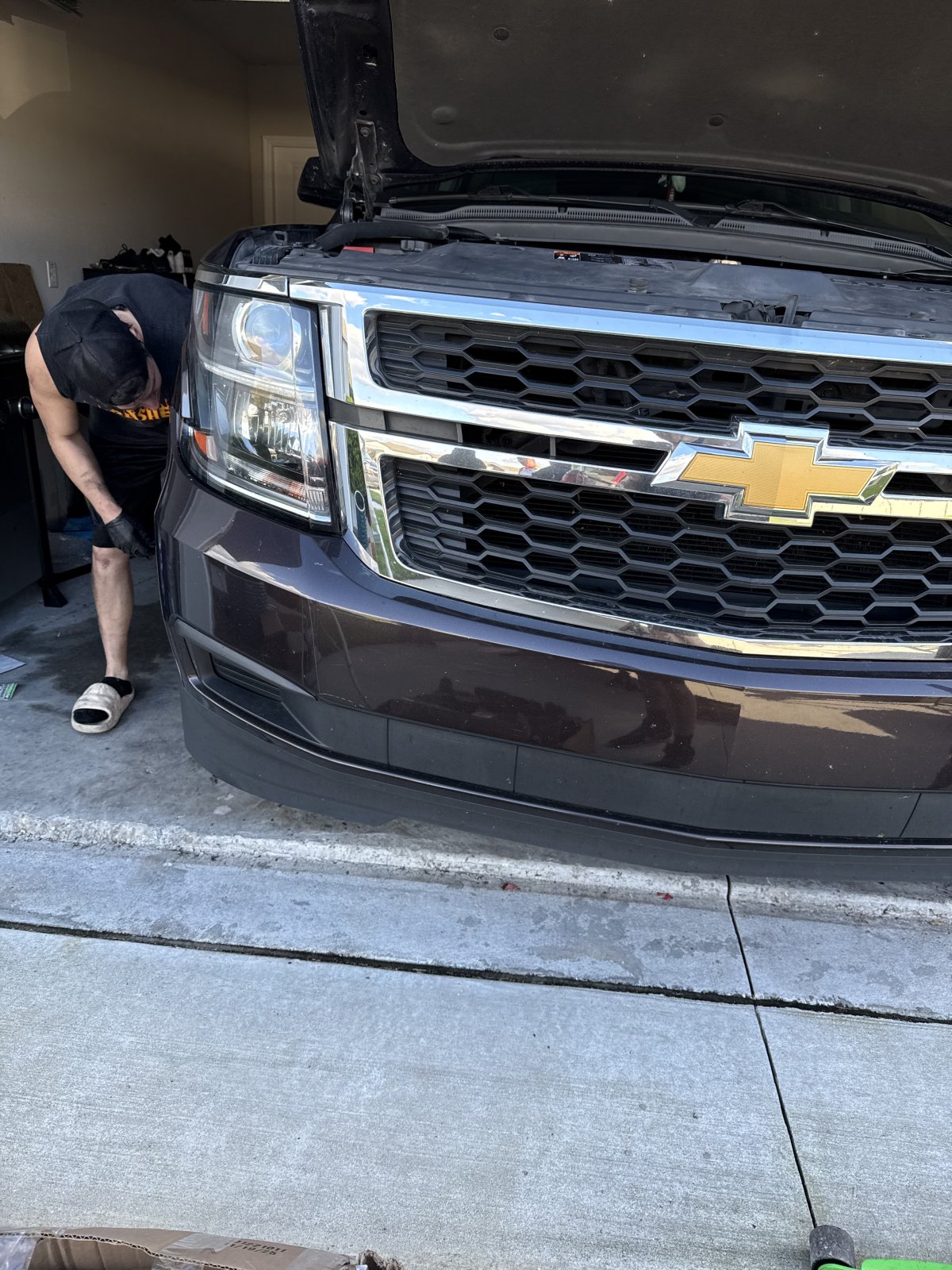

I’m in a pickle. My dash vets will not work. The buttons on the dash will let me choose both dash and feet vents, and just feet vents, BUT not just the dash ones. Everytime I choose just the dash settings it goes to both feet and dash. I looked on my driver side under the dash and I see the door mode actuator spinning everytime I choose a different setting for the air to blow. I was recommended to restart my HVAC system but I don’t know which fuse or fuses to pull. By chance, If I end up pulling the fuses and still face the same problem, what are your thoughts it could be?

Pics of the truck, please.
