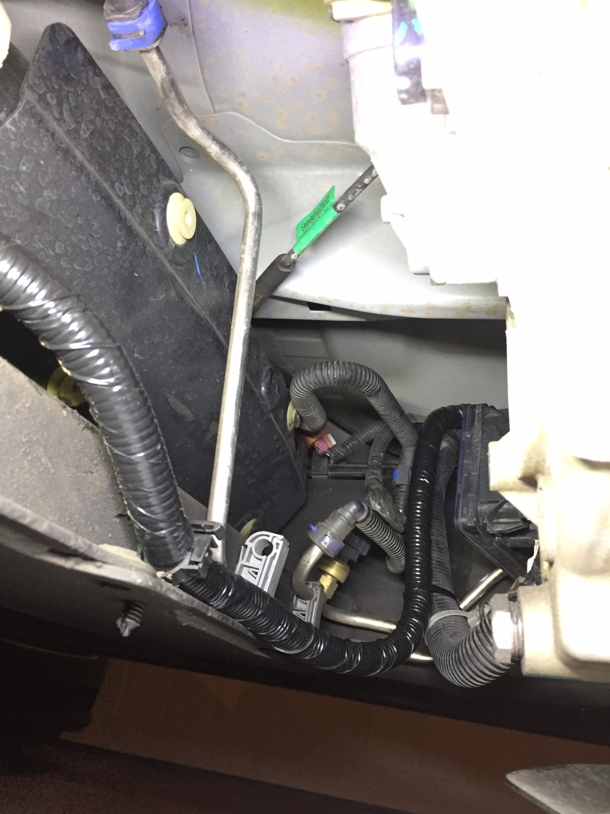

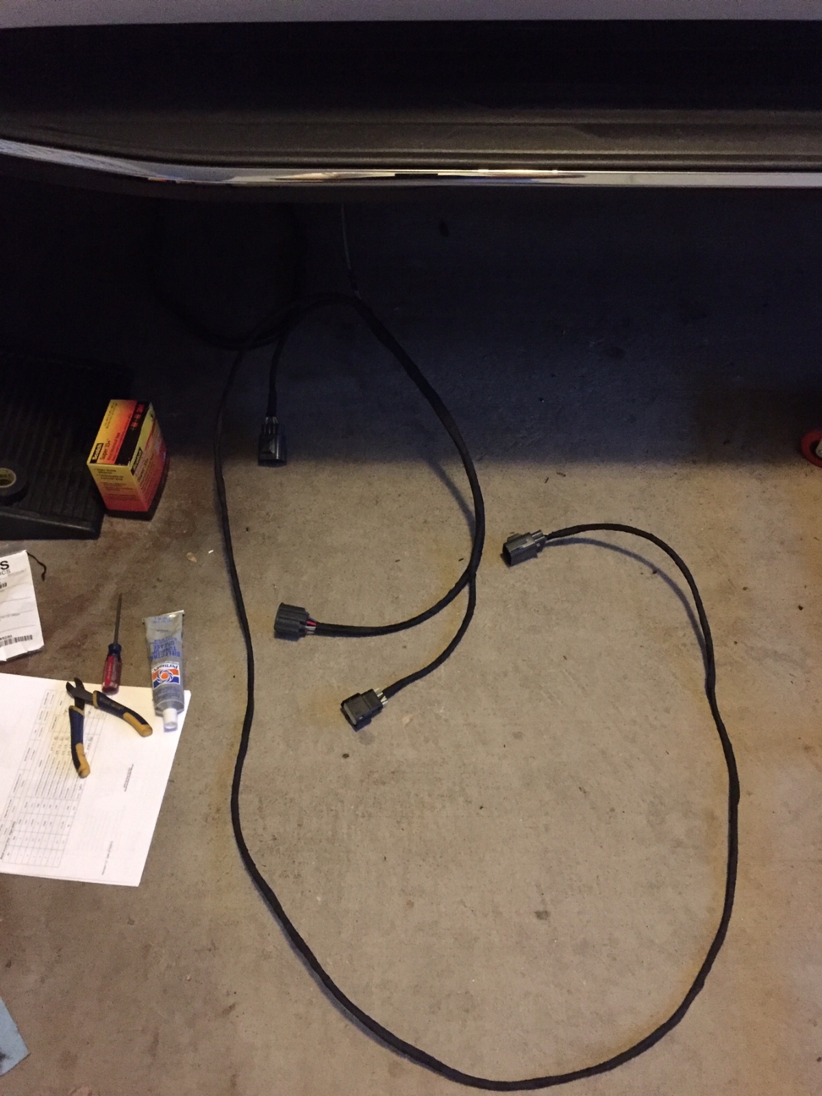

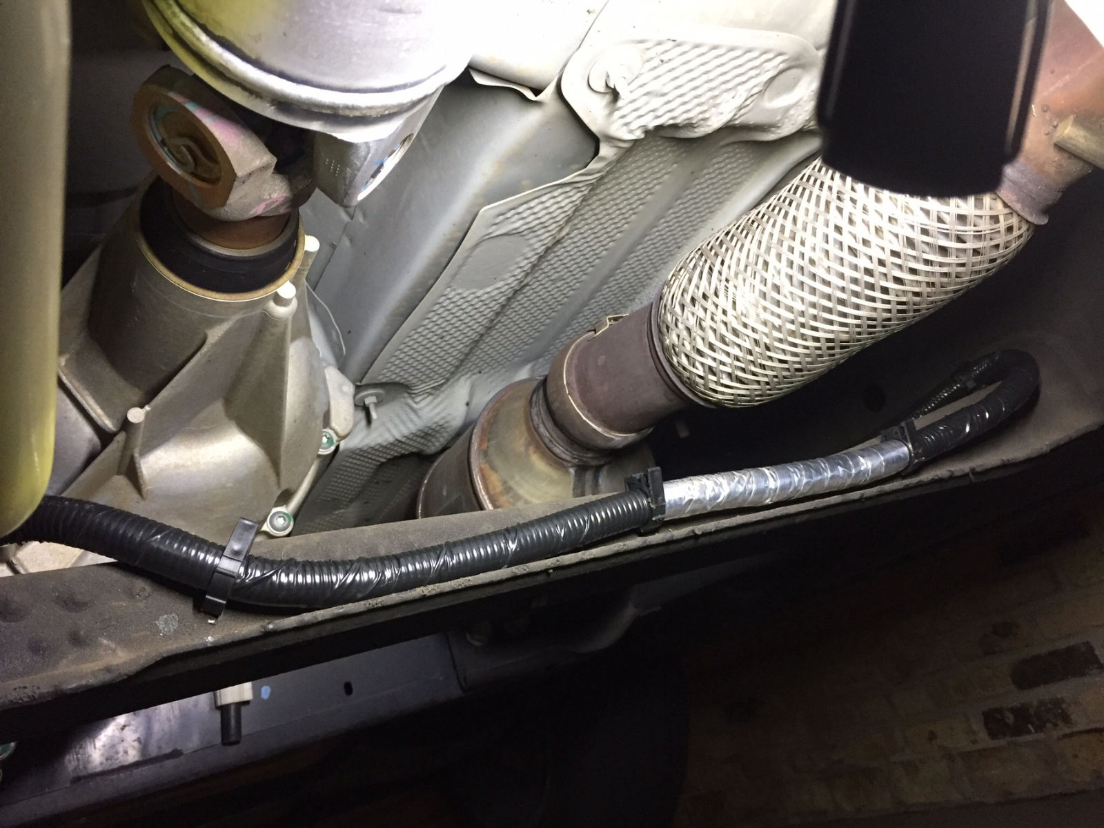

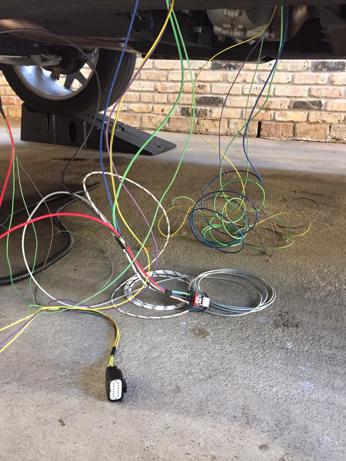

I believe it can be done. I’ve complete all the wiring. I’m looking for a good set of power assist steps now. There’s 3 circuits that come from the x185 body to chassis harness connector along with a power circuit from the under hood fuse block. The other wires connect between the module and the two steps. For the trucks, the module doesn’t have to be programmed. I’m thinking the suvs don’t either.

Here’s some pics where I wired everything up.
