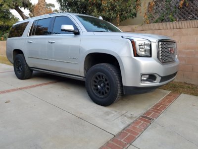

Or you could just go with a 2.5 inch supermax strut spacer for the front and a supermaxx rear spacer for the rear for a slight lift much cheaper than what I did but not as tall.

Okay great, appreciate it! So you think the oem 22’s will clear the Fabtech a arm?
Adam10532
Adam10532
May 29, 2017
141
52
no not without a wheel spacer , this fabtech kit requires at least 4.5 inch backspace rim. so for example I have a fuel 18x9 5 inch backspace 1mm offset

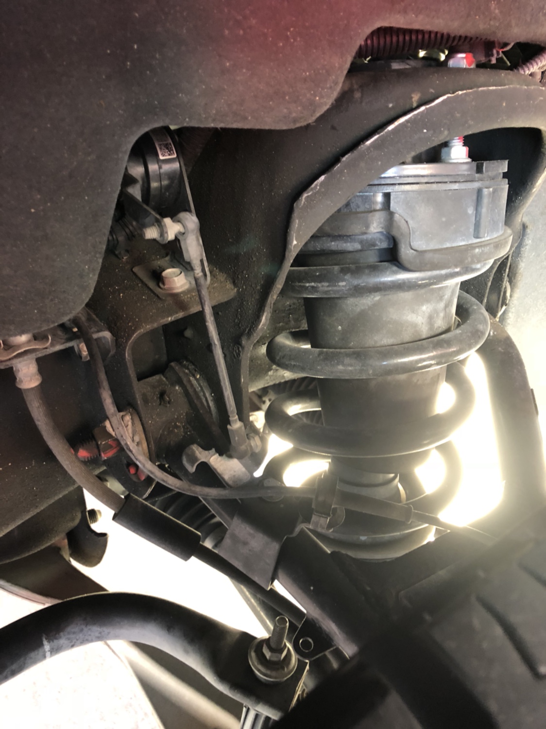

Man sorry it took forever! Here are the pics of my UCA
Thanks for the reply I'm kind of surprised you don't have a extension for Magnetic Ride sensor but hey it works
Joshb0718
Sep 18, 2016
51
21
Yeah idk all the details exactly on it but it rides level on the dash off road screen and doesn’t throw any codes, ride is still smooth!
