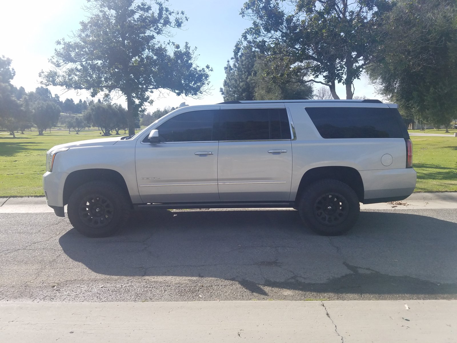

update since this original post I have went to a 2inch spacers in the rear not the 3 inch that came with the lift because as you can see from the above photos it was to damn high I currently have 2.25 higher "2inch spacer " in the rear i cant stand it I called fabtech and they are sending me a 1inch shorter spacer for the rear so I will have a end product of just about over 1 inch rake that will be nearly leveled. by the way to anybody looking for a 4inch lift keeping looking I have a true 3 inch lift all said and done fabtech even told me that do not even have a true 4 inch lift for my 2016 yukon xl denali 4wd it's a 3inch and there 6inch lift is really a 7.5 inch lift can you believe that so I was never going to get a true 4 inch lift i ended up with a fancy leaving kit. i will post pictures once my yukon has a.smaller spacer in the rear.

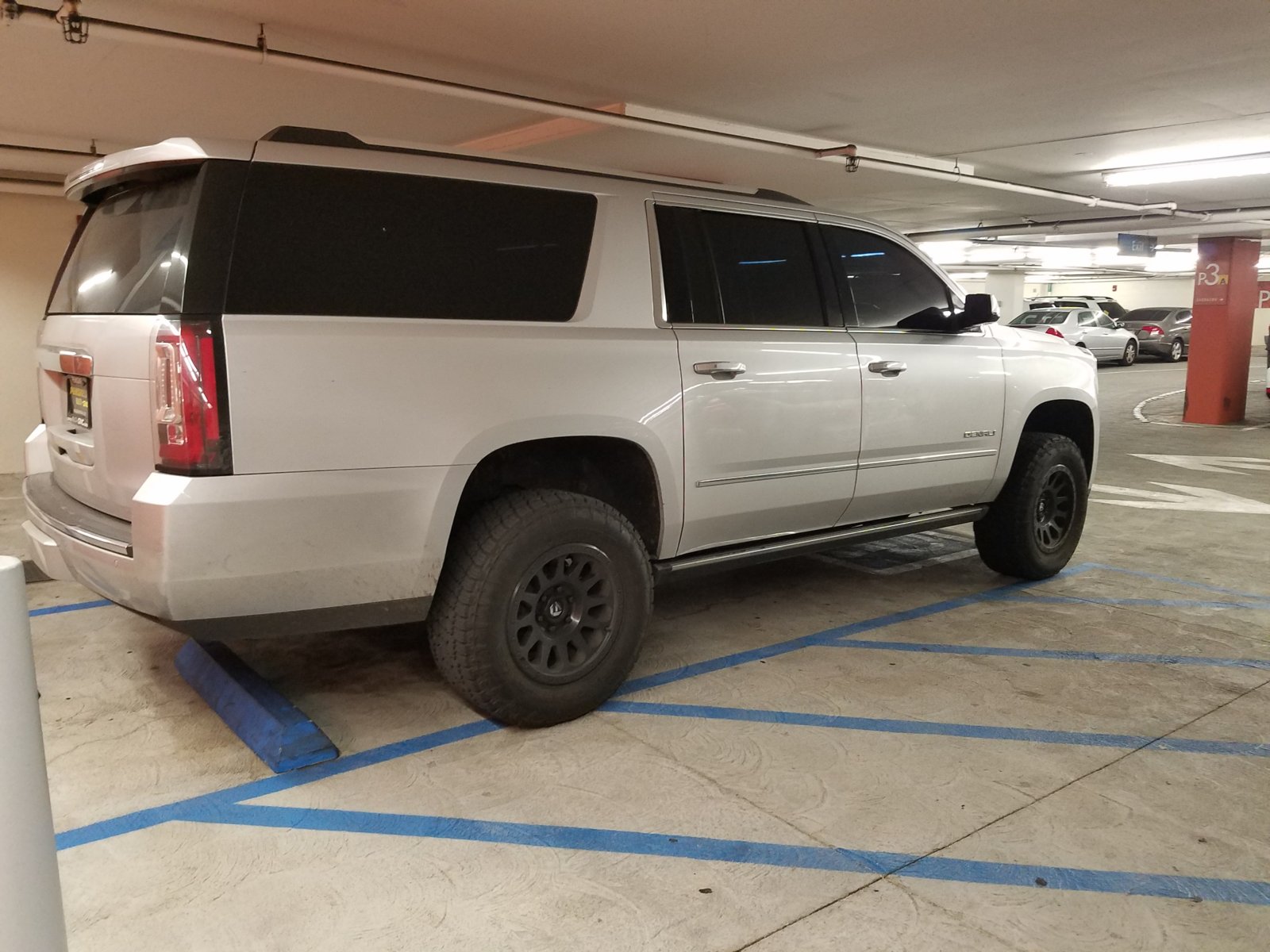

What kind of rear 2” spacer did you use? Do you have any photos of it?

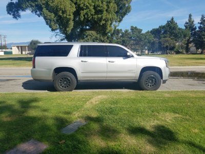

here are 2 photos with the new 2 inch rear spacer "fabtech" and keep in mind I have 4 inchs of lift in the front

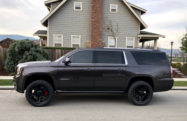

Just got mine done yesterday. Fabtech 4" kit, with a 1" spacer in the front under the strut, 1" suspensionmaxx rear spacer. 285/50R22 Nitto grapplers on OEM 22's. Rubbed on the steps, ordered amps to fix that. Also rubbed on the rear of the front fender when turning sharp, took the grinder and hammer out for that. Think I'm going to swap for the 1.5" front spacer. Its my wife's mall wagon so not concerned on the angles. I have a 1.5" suspensionmaxx fro the rear also.

I'm running the same size tires and I'm happy with them. in a perfect world id have a touch more offset than the factory 22s give, but I like the height of the tire. I'm running a 2" level kit only and rarely rub.
