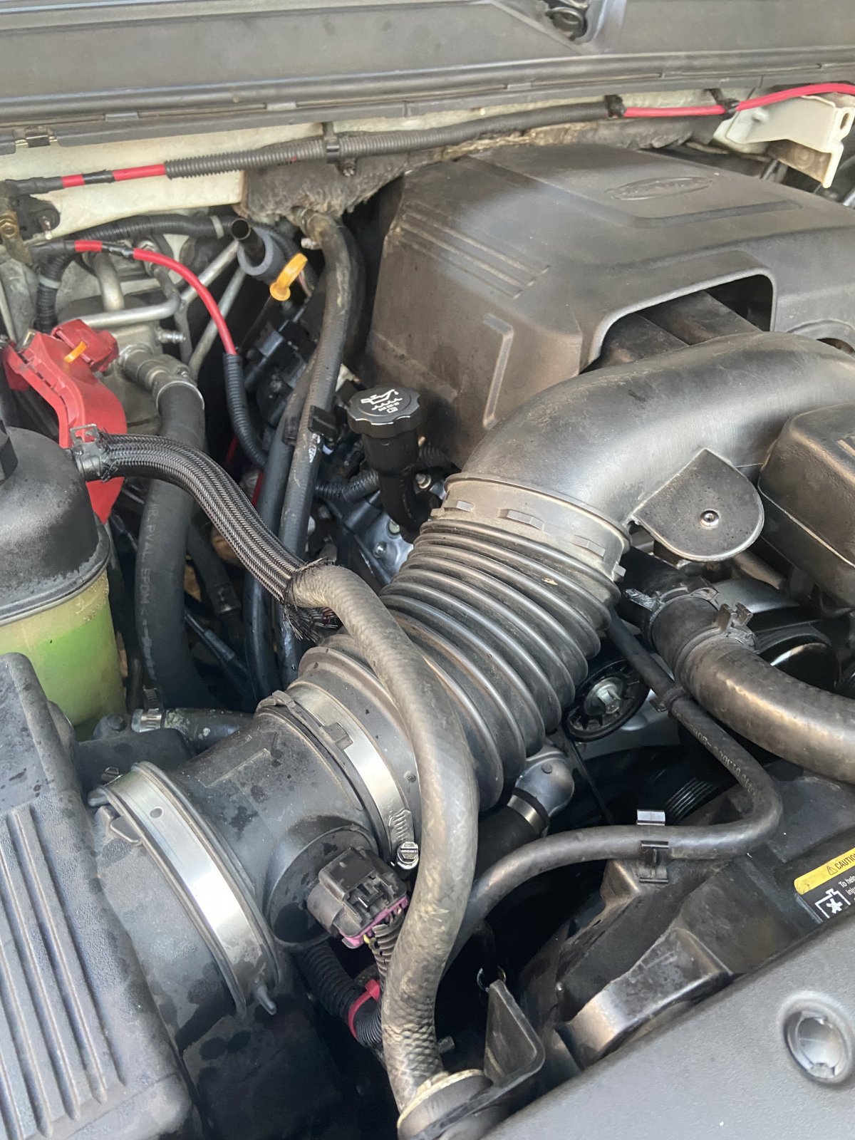

The first and last is my old engine and the three in the middle is my new one. John even replaced my header shields for free. He is awesome. I don’t work for him. I live in Texas now and I recently purchased a 2018 Escalade and when my engine fails I will bring it back to Cali to John for sure. I will have him order the engine and when it arrives I will stay in a hotel for 2 days while he changes my engine.
