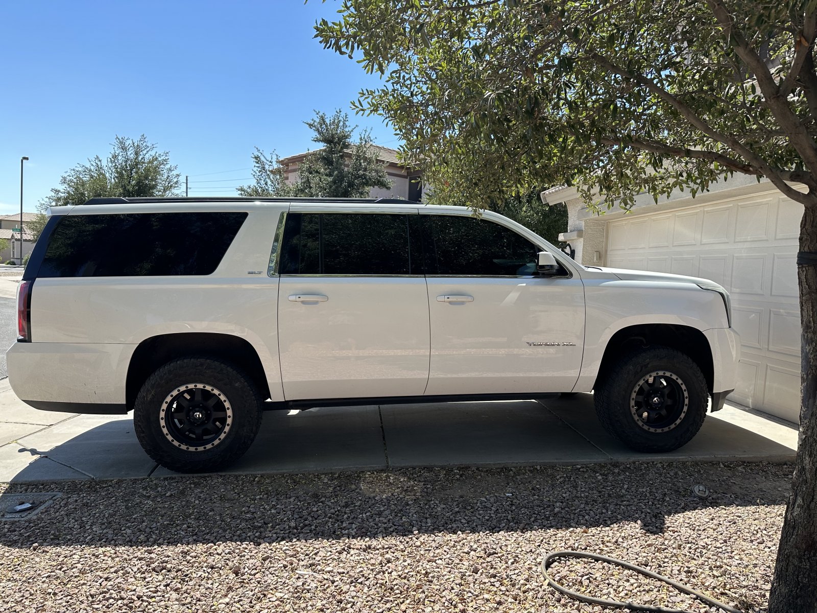

I would suggest scraping that air ride crap and installing these Dayton springs 351-897HD with Bilstein 5100 shocks 24-253260.. the ride is so much better.. Now I will say those springs will raise the rear about an inch of the factory height. Before your shocks were blown. I have a 2” leveling kit on the front and it sat just about level. If you remove the air shocks, you have to replace those springs because the rear will sag. They are designed to be helped by the air shock.

I unplugged my compressor, and removed the air ride shocks. It rides so much better now. There is a downside, I get a notification on my dash that says to service the leveling system every time I get in. I just hit the ok and continue my drive.. I personally don’t mind it, but if that would bother you then I would stick to the stock shocks..
