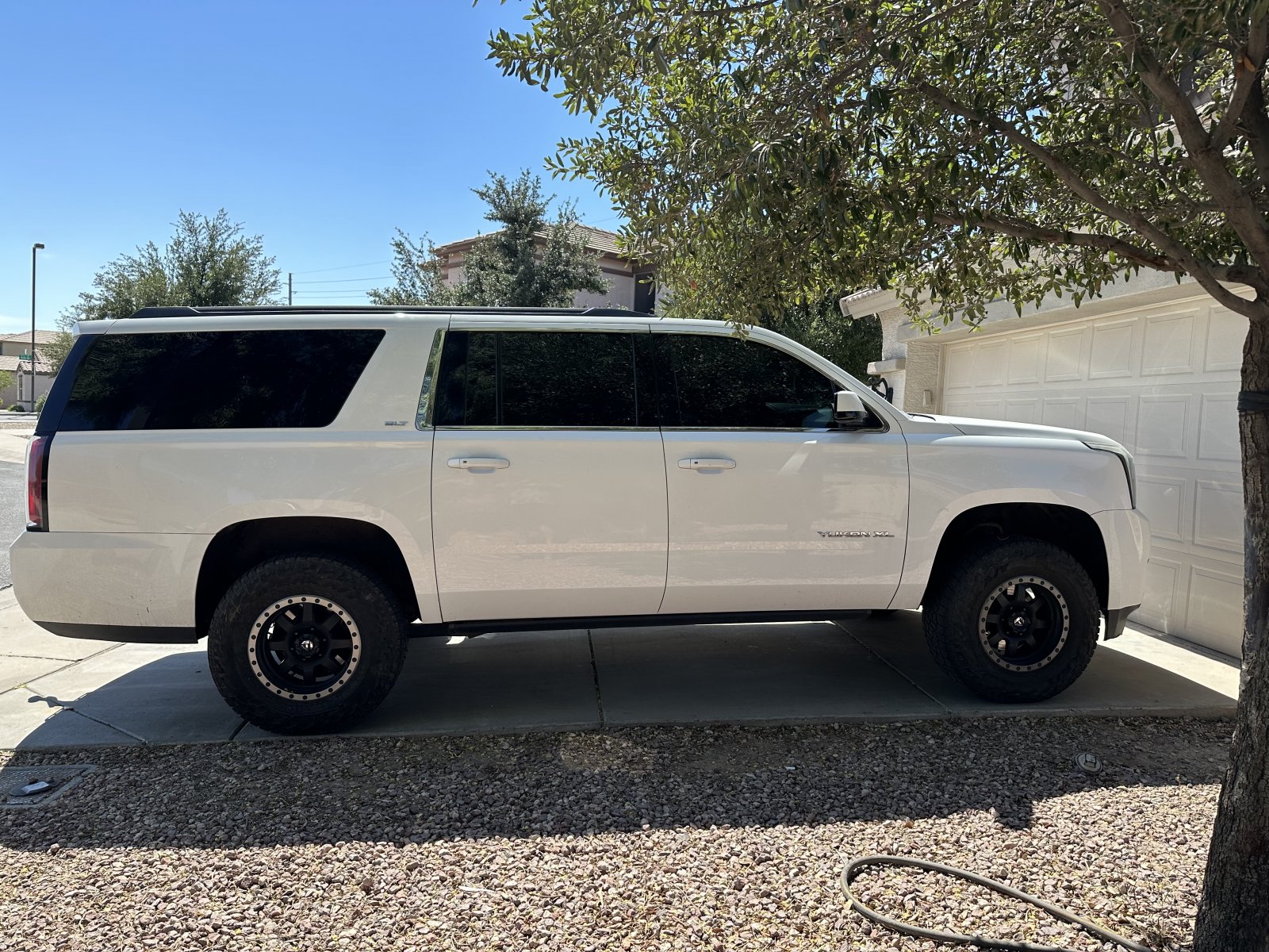

Here is how she sits with the Bilstein 5100s and the springs I mentioned, front has a 2” leveling kit.
