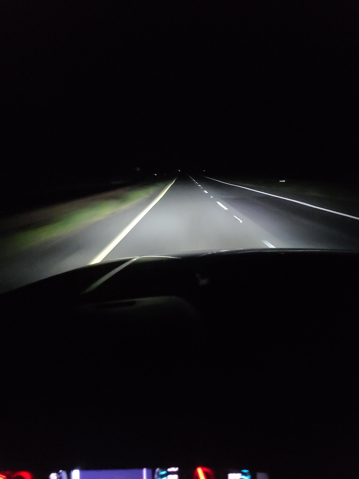

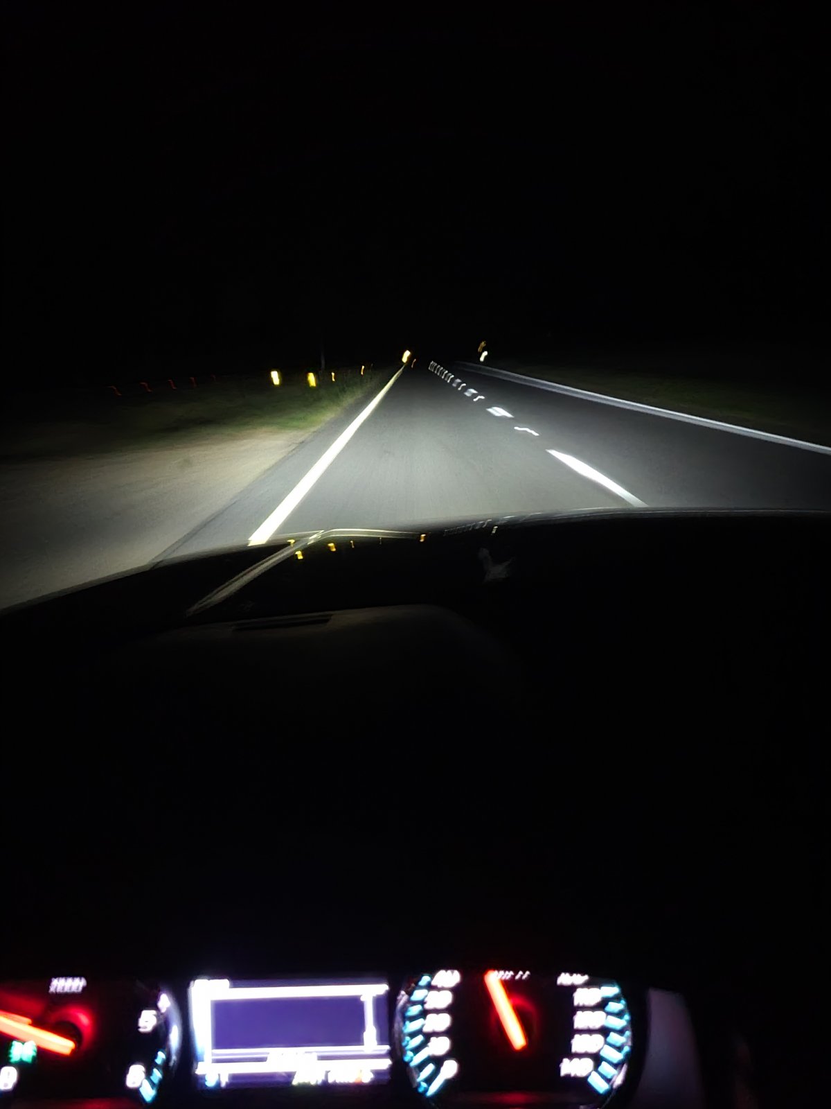

Ok for those wondering, the vled micro extreme ended up being better for me. I sent back the morimoto 2 strokes because there were dark spots in the beam and they just didn't have the distance. Don't get me wrong they were still better than stock by a good margin but not $200 worth.
The H11 vleds micro extreme were much better. Nice clean beam, defined cutoff and plenty of distance with these. These were easier to get seated in the housings to 3 and 9 o clock.

Would be very beneficial for other members if you could post some pics of the light output.
Did you get the 5K or 6K color clefs micro extreme?

I will do that. I ended up going with the 6k and they match the drls nicely. It may be tomorrow night before I can snap some pics but I will.
