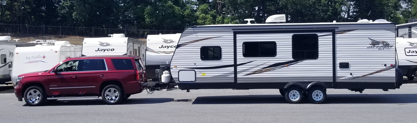

I have a 2017 Tahoe LT with Max Trailering. I purchased to specifically tow my Travel Trailer (5,850 dry weight)...

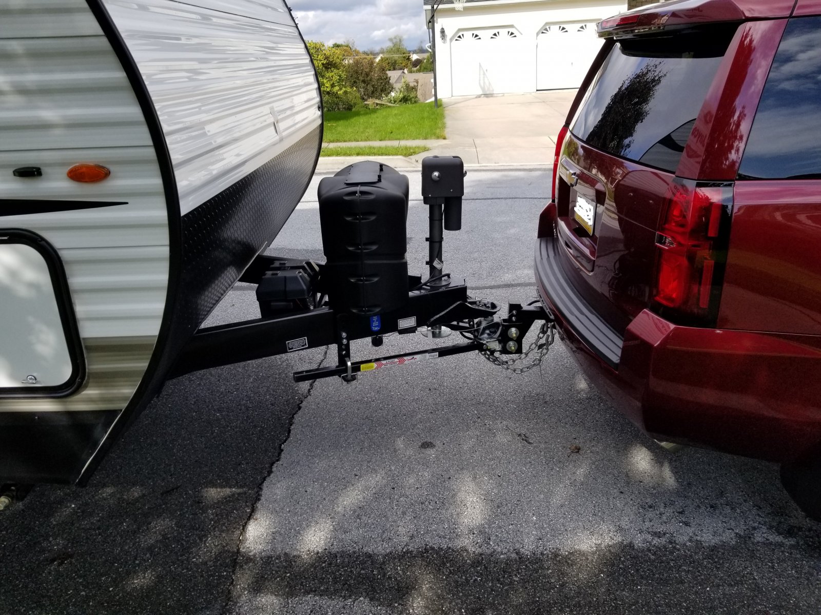

Hi, Jason. Your trailer looks to be riding fairly high. Did you flip the axles on it?

The W/D and the sway control are different things. Put the sway control on. You will be very happy you did. I ran two of them , tractors could blow by and no trailer sway whatsoever.
Equalizer 4 has built in sway control. I do not get sway from a tractors passing on the highway. Equalizer is not a frication based setup. I am able to backup or make tight turns without disconnecting anything.

I have a 2017 Tahoe LT with Max Trailering. I purchased to specifically tow my Travel Trailer (5,850 dry weight). Last I hit the scale, my trailer was around 6,200 loaded and have no problem towing. I use a good weight distribution hitch and keep it at 55-60 on the highway.
The Max Trailering Package is important because you get the 3.42 gears, break controller, sway control, heavy duty cooling, heavy duty suspension, etc
Furthermore, I went with the Tahoe LT vs Premier because the LT has Air Leveling Suspension vs the Magnaride. When I hook the trailer up, the Tahoe gets itself nice and level automatically.
What trailer is that? Looking to tow a grey wolf 26dbh with my 2018 yukon.
