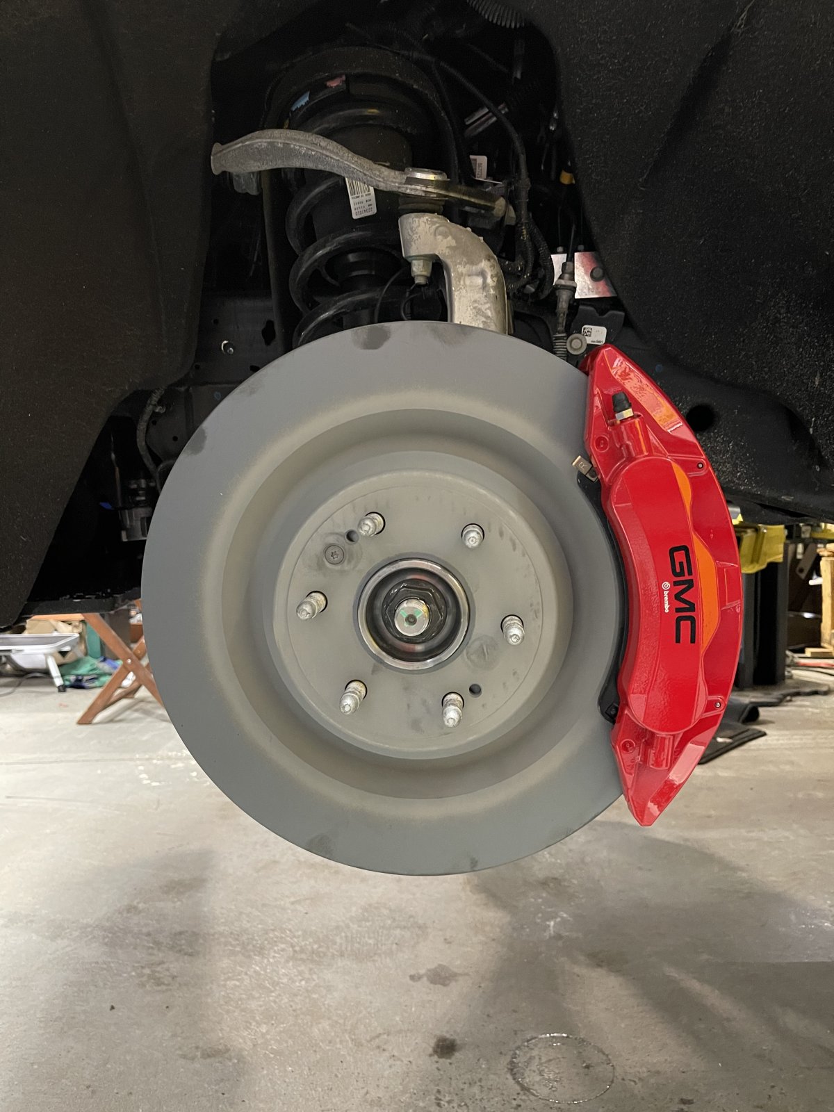

I'm either going to paint the calipers red with black brembo lettering or silver with black brembo lettering. Also, I just ordered monochrome badges and a black escalade badge for the tailgate. Should i paint the calipers red or silver?

Please report back with how much better pedal feel you have and braking power after this upgrade. I'm on the fence. A lot of squeeze for not a lot of juice, as it were... Or maybe it's worth it!

To be honest, I dont feel much of a difference. Pedal is a tad bit more responsive. No comparisone to my last escalade setup (Willwood 6 piston F/R). If I were you, I would wait until Wilwood produces a kit. I have been somewhat distracted with my service suspension light which has appeared 3 times tonight. I'm hopping GM will have a fix soon.
