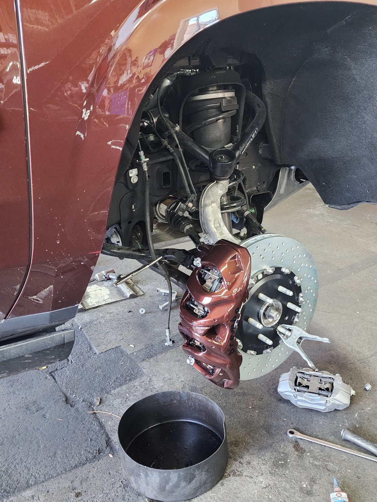

2021 Tahoe/Escalade Performance Brembo Brake Upgrade

Did you use the gm kit for the upgrade or the 2021 ppv 6 piston calipers? It looks like they are the same calipers, just unpainted on the ppvs.
Honestly, the 2021 PPV is a far better value. The hardware seems to be identical with the Brembo brake calipers being painted red.
