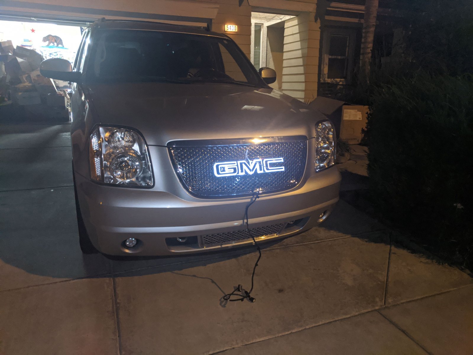

to put one on my 2012 I am pretty sure it's going to require some modification of my grill which is fine because the newer GMC emblem is larger then the old one, attaching it should be no problem and I put the same kind of thing on my Silverado the wire to the led is positive negative I can just tie into accessory power, piece of cake.
on that note when you receive your emblem it may arrive like my 18 silverado emblem did with 2 loose wires that you will need to pin into the connector, so before you pin the connector check to be sure which side is positive/negative on the vehicle end with a meter because once you stick those pins in the harness they are a real ***** to get out and swap the other way if you get it wrong.

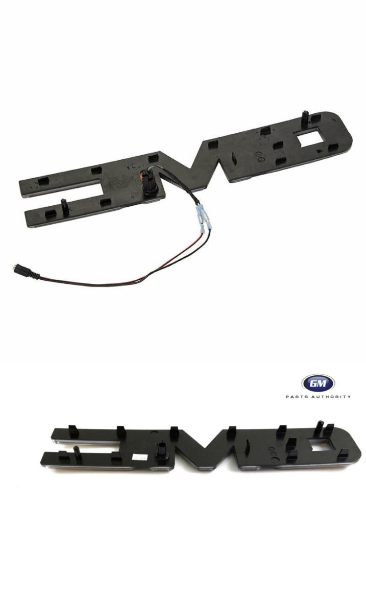

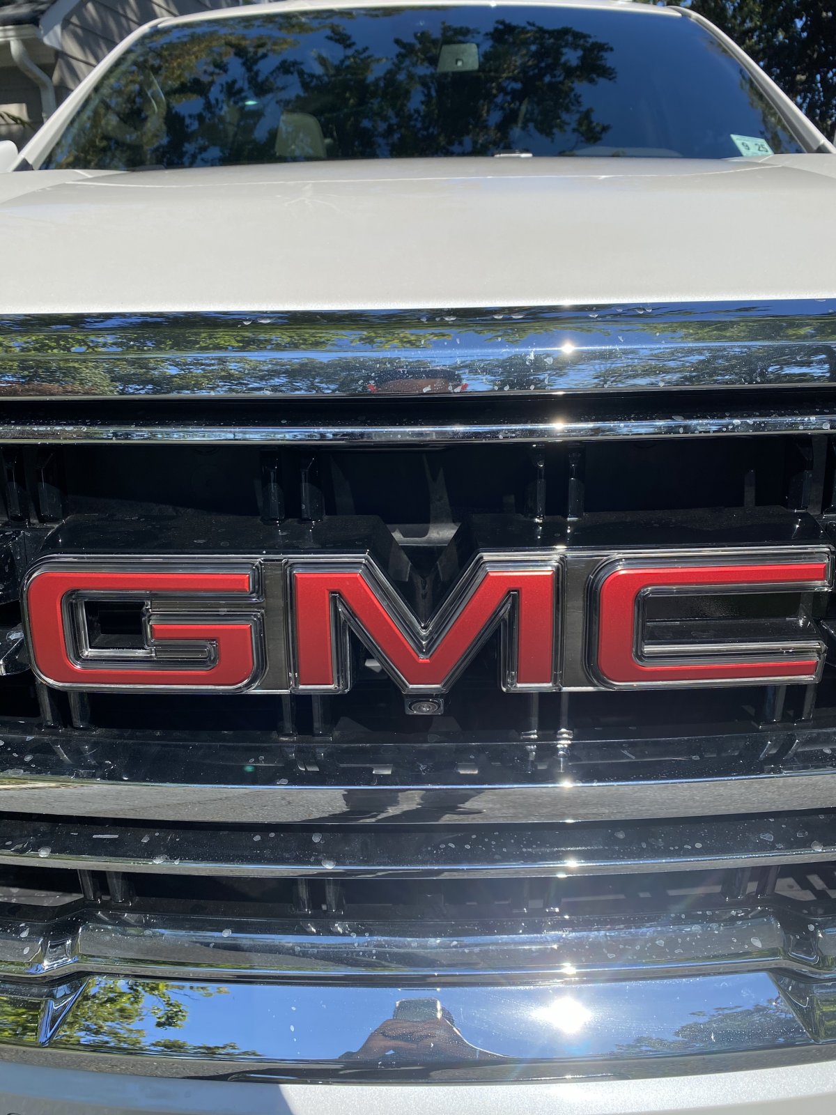

The kit arrived this afternoon, pics attached. Made a precautionary service appt for tomorrow morning in case I run into some snags.
here are pics of the kit. It is two pieces, the wiring harness pt #84437044
The GMC emblem is pre-assembled and all one piece, as opposed to the one on the grill now. I’m not unwrapping until it’s going in but I took pics anyway. On the back on the bottom leg of the M is the female adapter plug in case anyone was wondering where it connects.
no install manual is provided with the kit, just the reference to where to locate them in the SI.
the emblem is very well crafted and feels solid. The backing is black plastic similar to the grill material. There is no chrome outline as with the stock emblem, it is clear all the way around, which is what should illuminate.
very excited to get this in!
View attachment 259547 View attachment 259548
