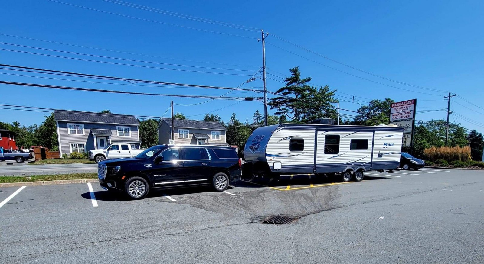

I have a 2021 Tahoe RsT Duramax. The biggest downfall when towing my 27 foot travel trailer is the Sag. You can not add an airbag since the shock is in the coil spring. I have been checking for 2 years and the only fix is a stiffer rear coil. It will take the ride quality away. If i could of done it differently, i would of bought one with the air suspension.

I had a 2015 Tahoe LT 5.3 with the Max Trailer Package which I used to tow a 28 Ft Travel Trailer which was said to have a 6,600 # Dry Weight. Using a Hensley No Sway Weight Distribution Hitch we travelled Coast to Coast in Canada & The US with no issues. I ordered a 2021 Tahoe LT with Max Trailer in January of 2021 which was never built. Ordered a 2022 in Aug 2021 and took delivery in Nov. I recently did my first trailer trip with it and it handled much the same as the 2015. The new additions to the Max Tow which is primarily the TPMS set up is great as well. I would recomend waiting for Max Tow.
