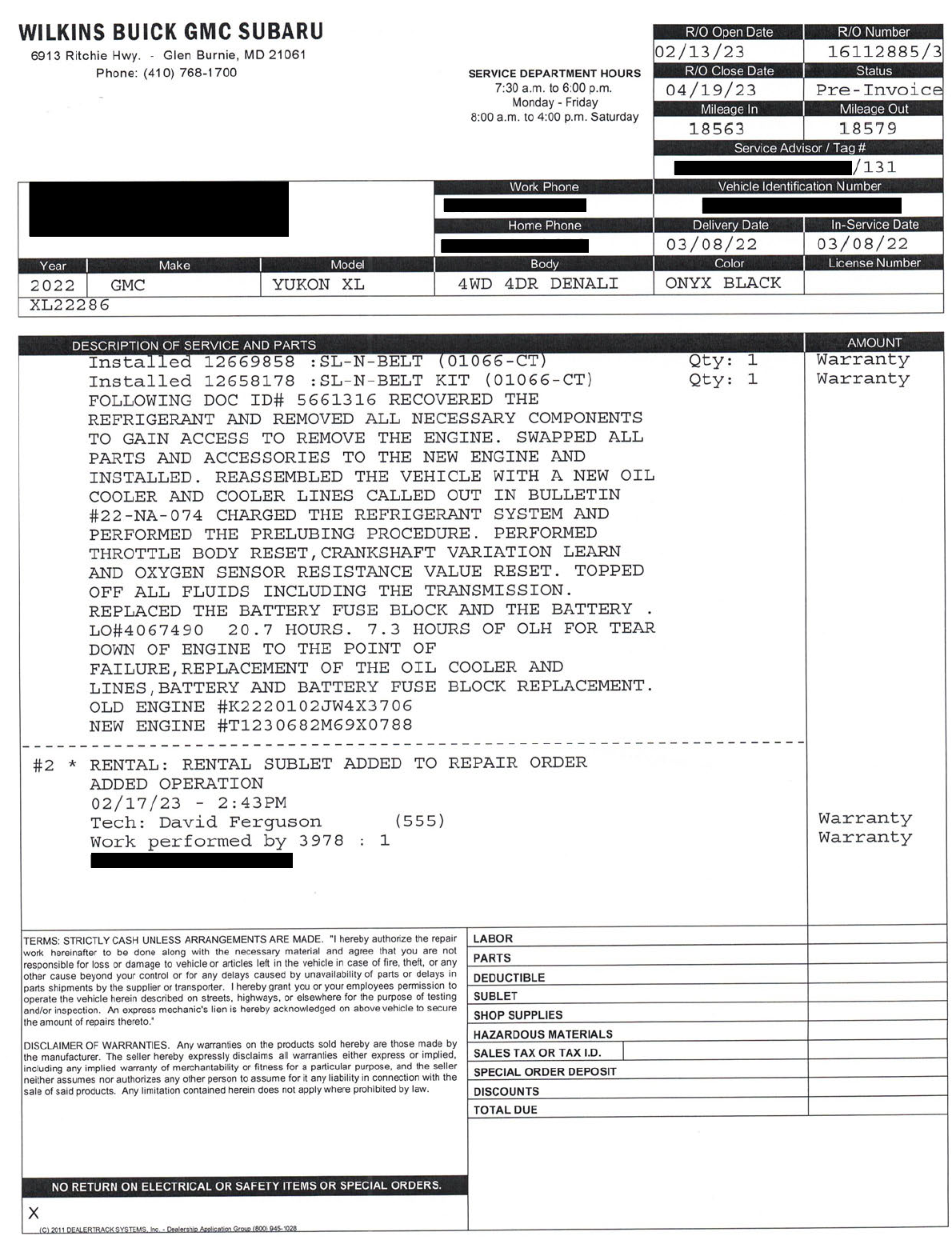

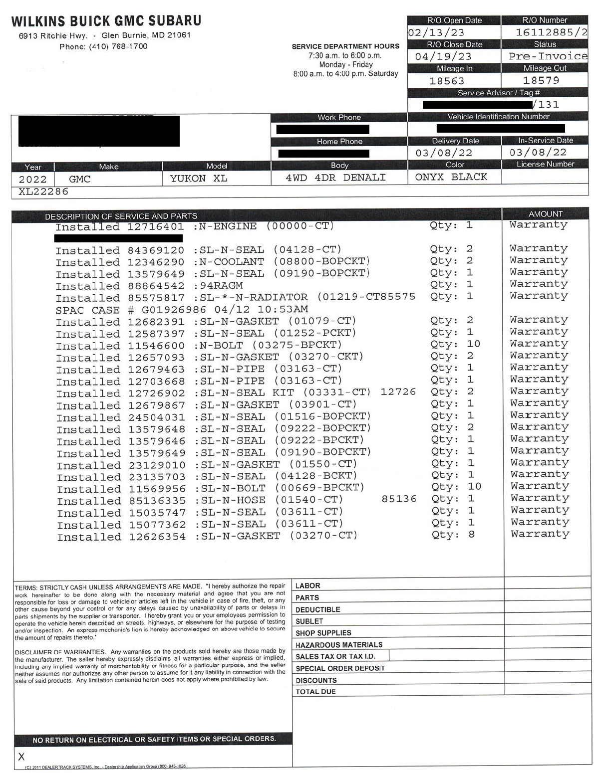

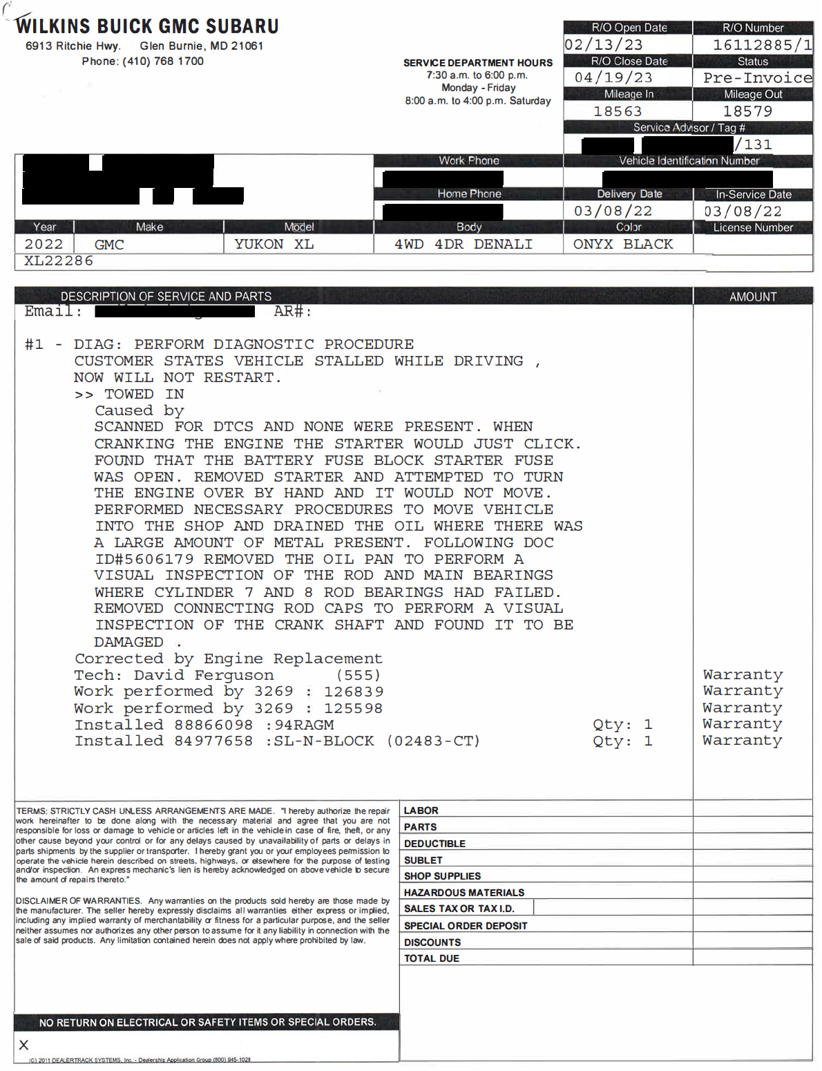

Hey please see my post - I went through this exact scenario. I’m about a week in on my new motor now. Dealer had my car for a month waiting on a new 6.2L. Tried to share relevant details in my posts but feel free to reach out if I can help.

Hi all,
About 3 weeks ago I had my Yukon with the 6.2L engine in cruise at 115km/hr (~70mph) when all of a sudden I realized I was dropping speed and noticed the vehicle was in neutral and the engine was off. No unusual engine noise occurred or check engine lights came on. I coasted to the side of the highway and came to a stop. When trying to restart the vehicle nothing would happen. I ended up having the vehicle towed to my local dealership where they tore into the engine and found that the crankshaft bearing had spun. Vehicle was purchased in December of 2022 and had roughly 5000km on it when the failure occurred. Anyways, the dealership is going to attempt to repair the failed parts.
I’m curious of your exact mileage - My rod bearings blew at 3,677 miles. (Cylinders 5 & 6) . Can’t just be a strange coincidence here.
I did the miles / KM conversion and you’re at around 3,106?
FYI, my starter motor was toast and also blew a 400A fuse from the handful of times I tried to get it to turn over before it was towed to the dealer. This was only discovered after they had installed the new motor.

My failure were the rod bearings on cylinder 7 which occurred at 5568km (3460 miles) on the engine.
Your starter was toast because it tried to spin a locked up crankshaft? That would be correct.
May 2, 2022
52
57
Pretty damn close … I wonder what GM’s thoughts are on these motors spinning rod bearings between 3-4K miles. There’s gotta be a short list of these somewhere in their system.
Sucks for us. Hope they get you back in order soon.
