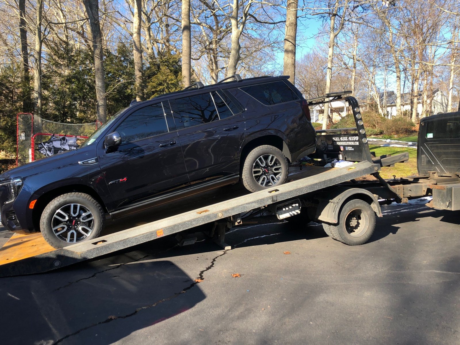

Yes brake lights worked. Tried service mode as per the manual -- all the lights came on but it still wouldnt shift into neutral (or start). Tow guys dragged it onto the flatbed and now i await the dealer. At least it was in my driveway and not on a road trip somewhere!
Everything described here just happened to me this evening. Had to leave my ‘22 Denali at the dealership since they were closed when it was dropped off. Hopefully, I can get everything reset in short order. I should also note for those who have yet to experience this - I’ve had my Yukon for 6 mos now, I have approximately 6300 miles on it, and have used my remote start religiously out of habit versus necessity. Guess it was my turn today. Thanks to all who have posted on this issue. Gives me a sense of relief to know it’s not a major issue.

olyelr
Mar 19, 2011
1,774
897
Elk Rapids, MI
Wow! Need more pics of your ride and specs…love the blacked out chrome against that color!
