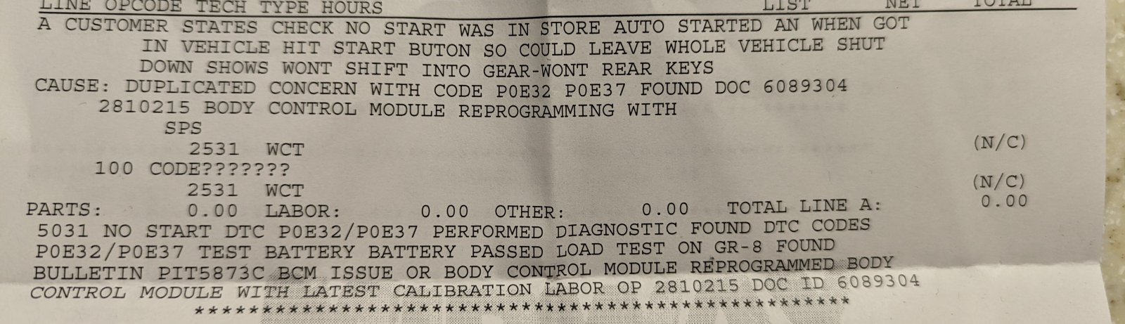

No suggestions regarding tools unless you are out of warranty and travel out of town, otherwise your best friend would be a obdii scanner to read codes at least if something pops up, those you can throw in the console or glove box.

NO, it's a software bug, if the problem occurs: remove negative battery cable for a minute and re-attach, drive on your merry way.....
welcome to Android
***just keep a 10mm handy in the glove box
That is all good advice, I have a 10mm in my ride now...that said, GM should fix this (assuming they can find the bug in the __M lines of code on this vehicle.
