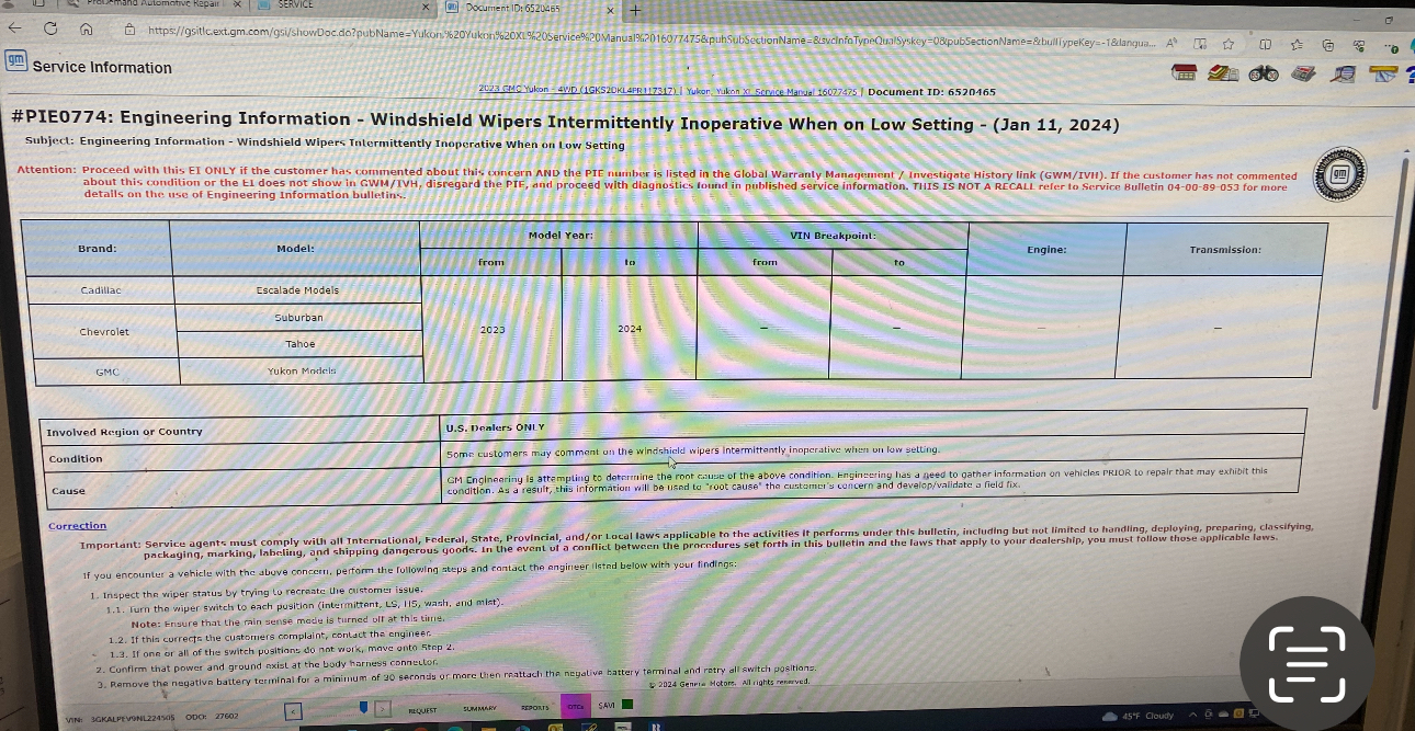

I called the local GM dealer and apparently it’s happened enough for GM to put out a service bulletin about it. The advisor said there may or may not be a recall come about soon. Until then, here is a copy of the bulletin
I'm sorry this happened to you and glad that you're safe. However, I am relieved that it has happened to someone else and you've found a dealer who is willing to acknowledge it.
That bulletin seems odd -- "ensure rain sense mode is turned off at this time". For a new truck, rain sense mode should always function properly. I don't want to have to utilize work-arounds to make my wipers work.
What is your next step? Will the dealer actually do something about it, or did they tell you to bring it in the next time it happens?

This is an "Engineering Information" document - similar format to TSBs (Technical Service Bulletins), but the purpose of this document is to give the dealership techs a process to follow so they can gather information regarding an issue. The Engineer at GM is listed in the document and information from the field is sent directly to them. Once enough information is gathered to determine root cause, the request is "closed" and then a TSB or Recall will follow shortly after.
My guess is they are asking the dealership to turn off rain sensing to eliminate that variable. If they can duplicate the issue without that feature turned on, then it helps with the troubleshooting process.
I see they only listed '23 & '24. There must have been a change in the system starting in '23 for them to know it only affects those model years. As I mentioned earlier in this thread, my '22 has had the wipers stop in the middle of the glass twice. It doesn't last for more than maybe a second, but they definitely stop. After the first time, I turned off rain sensing thinking that might be the problem, but I've since had it happen once with that feature turned off. It sounds like the issue here with '23 and newer is that they quit working for 10+ minutes...
If you have this issue, I'd highly suggest getting a video of the issue. Show that no matter which position you put the wipers, they don't work. Show in the video the setting for rain sensing - the more information the better and hopefully GM can determine root cause ASAP.
Thank you for this explanation! It's very helpful and now I feel there may be a light at the end of the tunnel...
I have multiple videos already (the 2 dealers I took it to had no interest in me sending any videos to them) but never showing the status of rain sense. I'll turn rain sense off and will hit record if it happens again.
