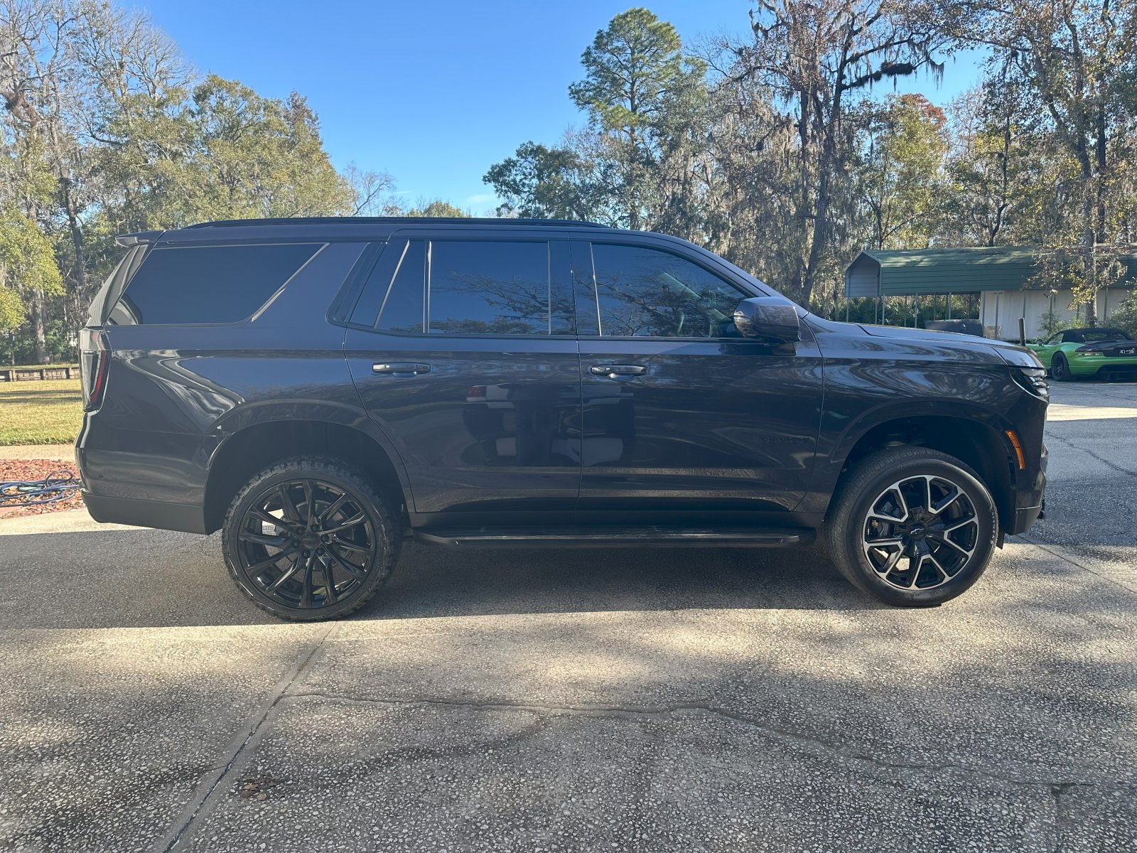

In the pic you sent, is that the car stance in 'normal' ride height mode? If so, can you take a pic of it lowered to the entry/exit setting?

So, the end fittings are the same size but the length of the rods is adjustable. All these do is adjust where the air ride sensor arm is in relation to the control arm. So basically it is tricking the truck into thinking it is at normal height even though it is lower.
The pic shows it in entry/exit setting. Normal ride height is a little lower than what entry/exit mode is stock, I think. I took measurements before lowering it but still havent taken the measurements after. Ill try to remember to take the measurements when I get home this evening.
I can tell you that if you set the rod lengths to approximately what he has listed (165mm and 108mm), most times you will have to trick the truck into entry/exit mode. If you pull up, stop and put it in park, it will begin lowering but most of the time before it gets to the correct height it flashes a message saying object detected under the vehicle and will begin raising back up to normal setting. The only trick I have found to get it into entry/exit mode is to select entry/exit mode on the switch about 10 seconds before getting to the final parking spot and pulling in very slowly. You definitely do not want to drive it at the entry/exit mode setting because you will be riding on bumpstops and its very bouncy.

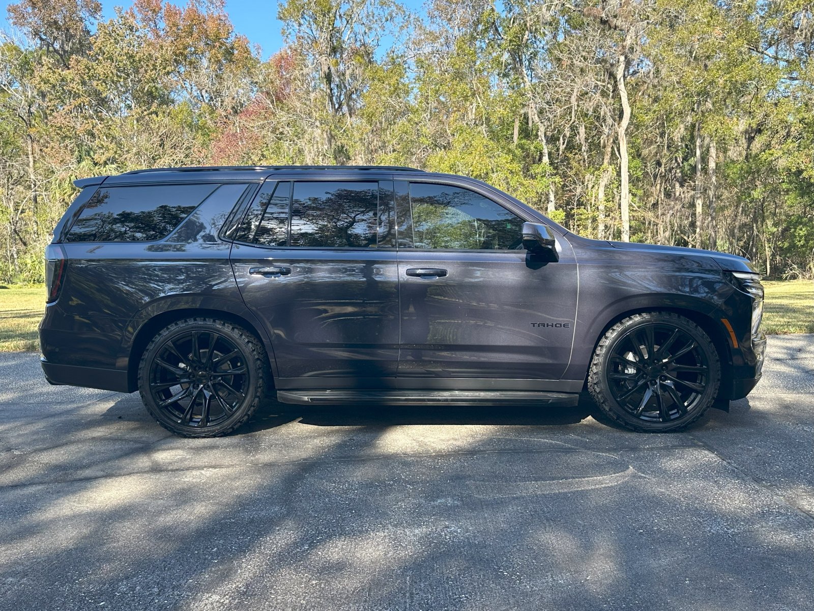

The wheels do look good. The GMT900 and K2XX platform required some higher offsets on both Factory and aftermarket rims and clearly the T1XX '21+ platform are wider and should have a lower offset to avoid the inset/tucked look like you have going on. It's not a good or bad thing, I think maybe more of a preference thing and potentially some impact on the larger OEM 4 piston front brake calipers.

I prefer the look of wheels tucked a little vs flush. I would definitely need spacers if it had the larger brembo brakes but these fit fine over the regular calipers.

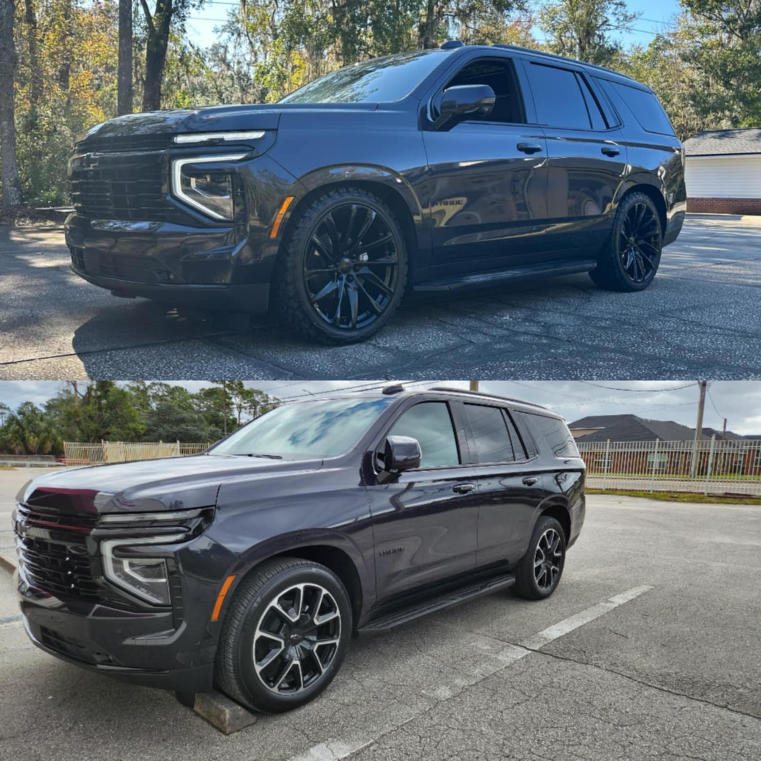

I took measurements again last night. Its right at 1.5" of drop if you set the links to what are on the instructions. Of course I went from stock wheels and tires to larger wheels and tires so depending on your setup it could be a bigger difference. I rounded everything to the nearest .25" so they could be slightly different and I measured at the center of the wheel from the floor to the bottom of the wheel arch. Theres about 4" of total travel from the entry/exit setting to the highest 4L setting.
Stock Height-Normal Setting. Lowering Links-Normal Setting
Front Right-36.75" Front Right-35.25"
Front Left-37.25" Front Left-35.75"
Rear Right-37.5" Rear Right-36"
Rear Left-37.75" Rear Left-36.25"
Stock Height-Entry/Exit. Lowering Links-Entry/Exit
Front Right-35" Front Right-33.5"
Front Left-35.25" Front Left-33.75"
Rear Right-36.25" Rear Right-34.75"
Rear Left-36.5" Rear Left-35"
