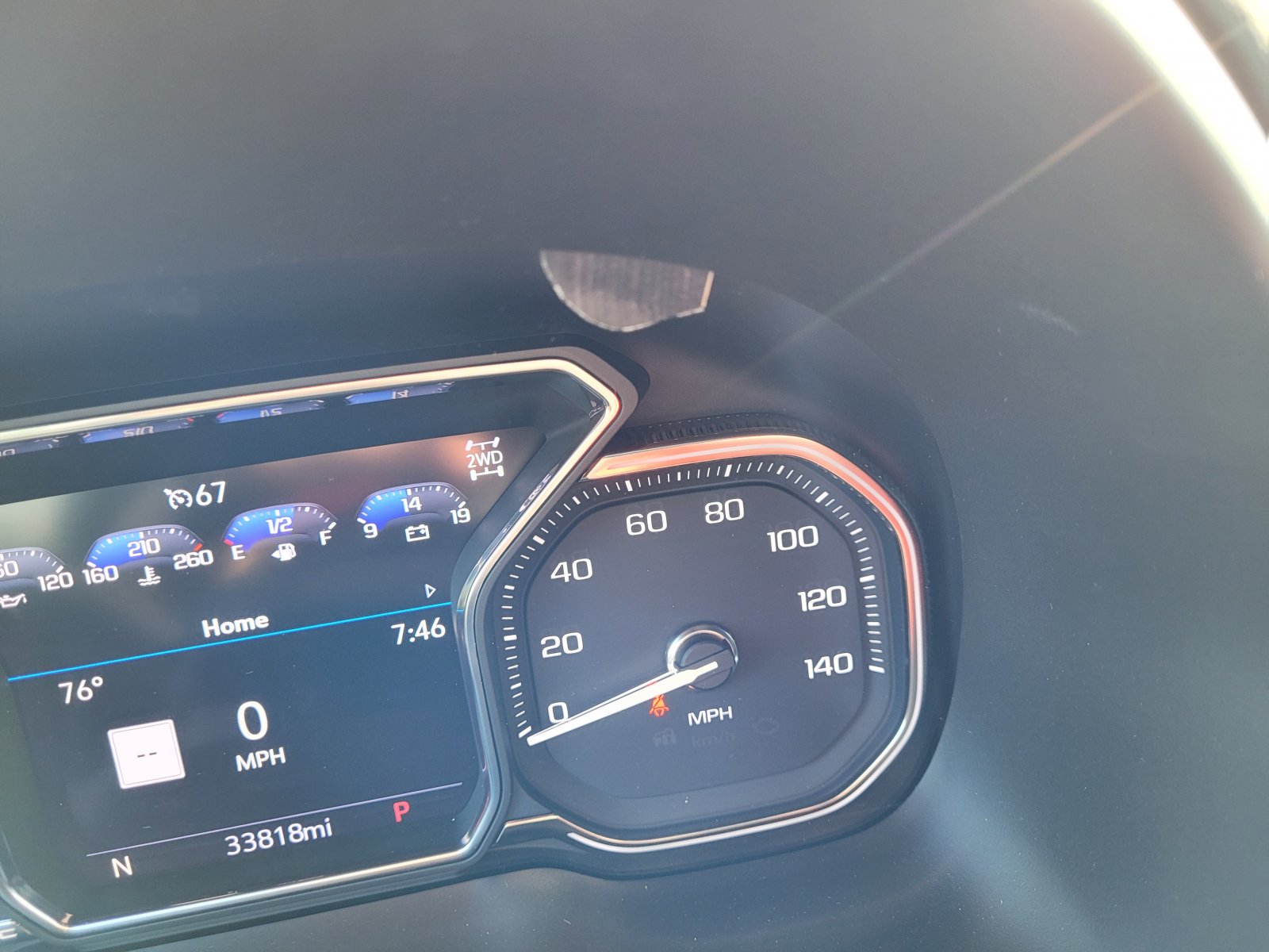

Are you all getting warranty satisfaction here? I’ve got a dash rattle that is driving me nuts.
I was about to tear the dash out of my 2023 suburban with this issue but after riding in the passenger seat and tapping the dash and infotainment screen I realized that it was actually the plastic around the rear view mirror and the sound was resonating down to the dash. I put a little foam strip between it and the windshield problem solved. Hope this helps I have seen many people with this issue on Tahoe/Yukon/Suburban
