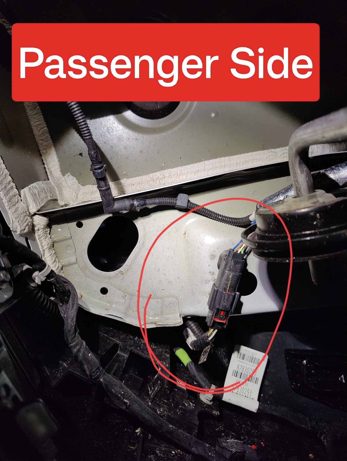

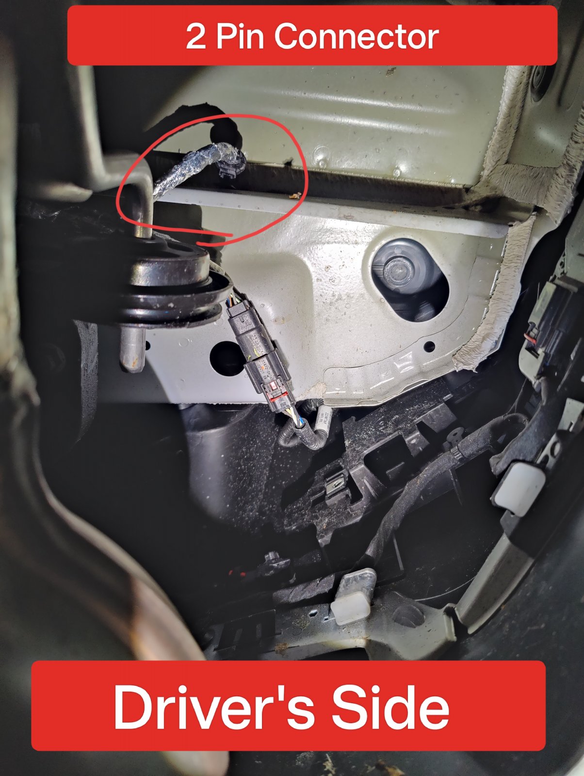

I'm happy to report that my plug and play harnesses seem to be functioning as expected. No warnings or errors and all the bulbs have been replaced with LEDs. Hopefully tomorrow I can provide you all with some ordering info if you are interested.

So this harness just inter-connects under the rear quarter panel and provides the resistors for all three bulbs?

These are new harnesses that will be available soon at Gen5diy.com. I've provided them with an install video and they will have them listed for sale soon. I'm not aware anyone else offers these. I've seen people tap resistors in behind the tail lamps but I've measured temperatures on these resistors at 230 degrees fahrenheit plus so I really don't see how that's a safe way to do this and there isn't a lot of room behind the fixtures anyway. I also hate tapping wires and this solution is plug and play.
Deuce16GMCs
Deuce16GMCs
Aug 11, 2016
205
124
Yes, correct. No one else offers anything like this. Every other LED manufacturer that offers you the resistors tells you to plug them in in line with your bulbs or put a harness behind the lamp.
Truly grateful you've taken the time to develop test something like this that will be plug and play underneath the vehicle for the heat won't damage the headlamp.
Especially if we're able to run all three bulbs on the same harness without any dash errors.
