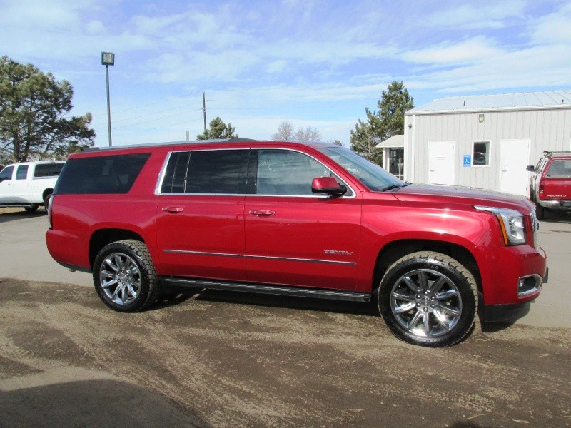

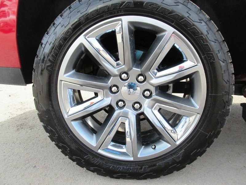

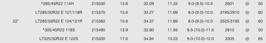

What is the biggest Nitto tire size I can go with on stock 22" rims with stock truck
285/45/22 is oem
but can it fit.....
305/45/22?
or
285/50/22?
or
285/55/55?
Would like the 305/45/22 to fit but unsure? Any input or thoughts would be great, thanks
anyone ever get any pics? I have been looking at replacing the tires on my wifes tahoe, and can't figure out if i can do a 285/50, 285/55, or stick with 285/45r22. the front is leveled, just haven't measured to see exactly how much it is raised up
305/45/22 on mine, for now, with no leveling or rubbing - stock ride height.
