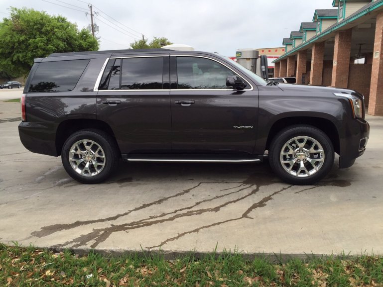

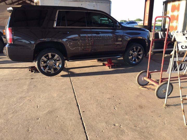

MPG 22 inches
I drove a 15 with the 18's with 4wd for a few days. I was averages 18 mpg with it. I ended up buying a 15 with the 22's on it. I get just over 15 mpg in this one, and a noticeable difference in ride quality, especially at higher speeds. But, Ill take the 22's all day.
