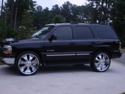

I just put 26's on my tahoe this past friday and i paid $2800 to the door. I went with the 305/30/26, but my truck is not a daily driver either. a friend of mind just swapped out his 305's for 295/25/26 so he can turn better. I have full turning ratio on my tahoe but he has a yukon denali xl.

Your also alot higher stance and a NBS, Roadrageor is an OBS with a drop.
After seeing that pic I don't know if the rims will tuck. I honestly think you are better off going with 24s, but thats all up to you man.
Good luck
---------- Post added at 08:41 AM ---------- Previous post was at 08:34 AM ----------
Also Roadrageor the tires you currently have on you denali are ~28.3" tall (265/30/22). The tires on the truck above are 33.2" tall (305/30/26).
I mean your talking about a tire thats 5" taller than the tires that are currnetly on the denali. Even if you went with the 295/25/26 mentioned you will still have a 31.8" tall tire, thats not much sidewall at all for a truck that gets driven on the street.
