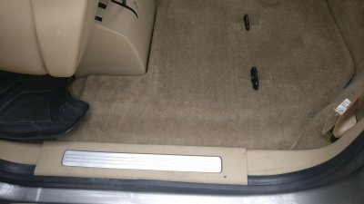

But, the devil's in the details, or in this case, the carpets. We thought that we could just switch carpets along with the seats and have everything work out perfectly. We were wrong.

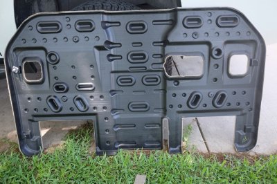

See, GM changed the interior spec of the GMT900 Suburban in 2010. So, there are not one but two possibilities for the carpeting that covers the second row seat hardware and the third row footwell area:
- hard plastic covers, or
- a carpet trim piece with sound deadening material.
The trouble is that, with this change, GM changed how the two piece primary interior carpet works. With the hard plastic covers, the two pieces of interior carpet meet right under the second row. The entire floor is carpeted, the seat frames sit on top of the carpet, and the trim piece protects passengers from injuring themselves on studs.
With the move from the hard plastic covers to the carpet trim piece, the two piece carpets are shorter, and the body floor is bare under the second row.
The carpet trim piece insulates and covers this from sill plate to sill plate, the full width of the vehicle.
Bwiggins1985 gave me his hard plastic cover.
It left a gap in the carpet on each side. For now, I've filled that gap with a custom cut piece of scrap carpet. Long term, I'll want to either obtain the correct carpet, or, put some insulation under the hard plastic piece. Right now it's just a bare floor under that piece.
I gave Bwiggins1985 my carpet and it added thickness to his carpet at the sill plates. He had a tough time getting the sill plates installed. He's going to order hard plastic covers for his captain's chairs.
