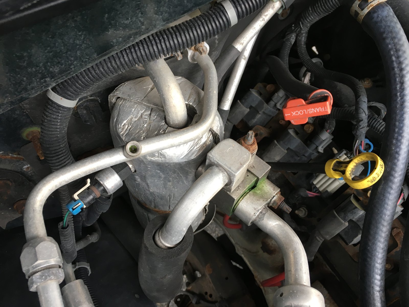

So my 3" body lift is putting a lot of strain on my AC hose to the dryer. See the dye. What have you guys done to fix this?038.JPG

Evac the a/c, diconnect the tubing and very gently bend it to a better angle, REPLACE the oring at that connection. (While the system is apart you may want to go ahead and replace the accumulator and check/replace the orifice tube.) button it all back up vacuum it down, check for leaks and if all good recharge the system.

OK, thanks. I was thinking that I needed to bend it a little.
