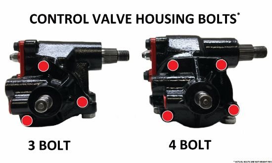

Sorry Im referring to the steering boxes themselves some have three bolts in the housing and others have 4

The only difference that I can see is that the 3-Bolts have a 14mm (.568”) diameter input shaft. The 4-Bolts have a 16.76mm (.66”) diameter input shaft.
Yea, you can see a difference in the diameter of the shafts, in the pics.

Thank you all for you input. My application is a 2005 Tahoe LT 4x4 5.3 with hydro Boost . I have put 5 steering gear boxes in my tahoe ranging from remas to new ones. and even a Red Head box. but they all develop excessive input shaft play. When you look them up on a parts website they ask you if your unit is 3 or 4 bolt. I was wondering if the two were interchangeable?
